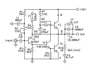

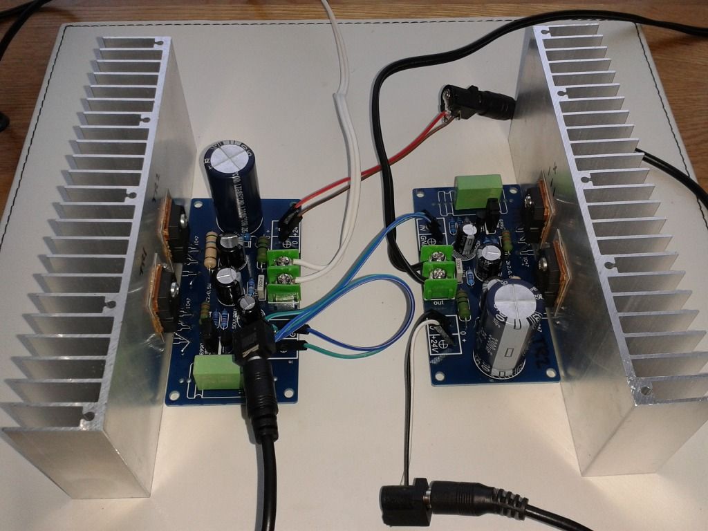

I am building this amp acording to this schema:
The first channel I built works fine and sounds fantastic, but I have large dc offset at second channel output.
PSU voltage is 22V, by trimming R2 I can get DC at the output anywhere between 10-17V, but I cant get rid of it. I checked all output caps and they are good.
Any ideas?

Try to add let`s say some 470-ohm 1/2W resistor from output + terminal to ground line ,
turn on your amp ,wait several seconds ,and than check DCV across output terminals again,
since is easy possible that your voltmeter have way to high internal resistance and can not fast enough to discharge pretty big value(11.000uF!) of output capacitors stored charge .

Post3304 is a single supply amplifier with the Input and Output AC coupled.
Point B always has a voltage above ground. At no output current point B is at roughly half supply voltage.
The Coupling/DC blocking capacitors block that DC voltage and prevent that feeding into the load.
Any leakage through the Coupling capacitors will be measurable as a DC offset at the OUT terminal.
This arrangement always uses a grounding resistor to take that leakage current to PSU ground.
Fit a grounding resistor from OUT to PSU Ground, use a value >>load resistance and maybe 100*load resistance.
Low leakage capacitors could use >100k, but electrolytics will need a much lower grounding resistor.
Once that is fitted the output offset at OUT will be near zero milli-volts.

I would set it to 11 Volts, then connect a few hundred Ohm resistor to the output pins, and measure again.
Thank you for quick replies. I was scared to hookup 10+V DC to speakers, but it turns out, just as you said offset is like 5mV with load connected.
Both channels are running, sounds much more detailed and bass is better than my LM1875 amp.

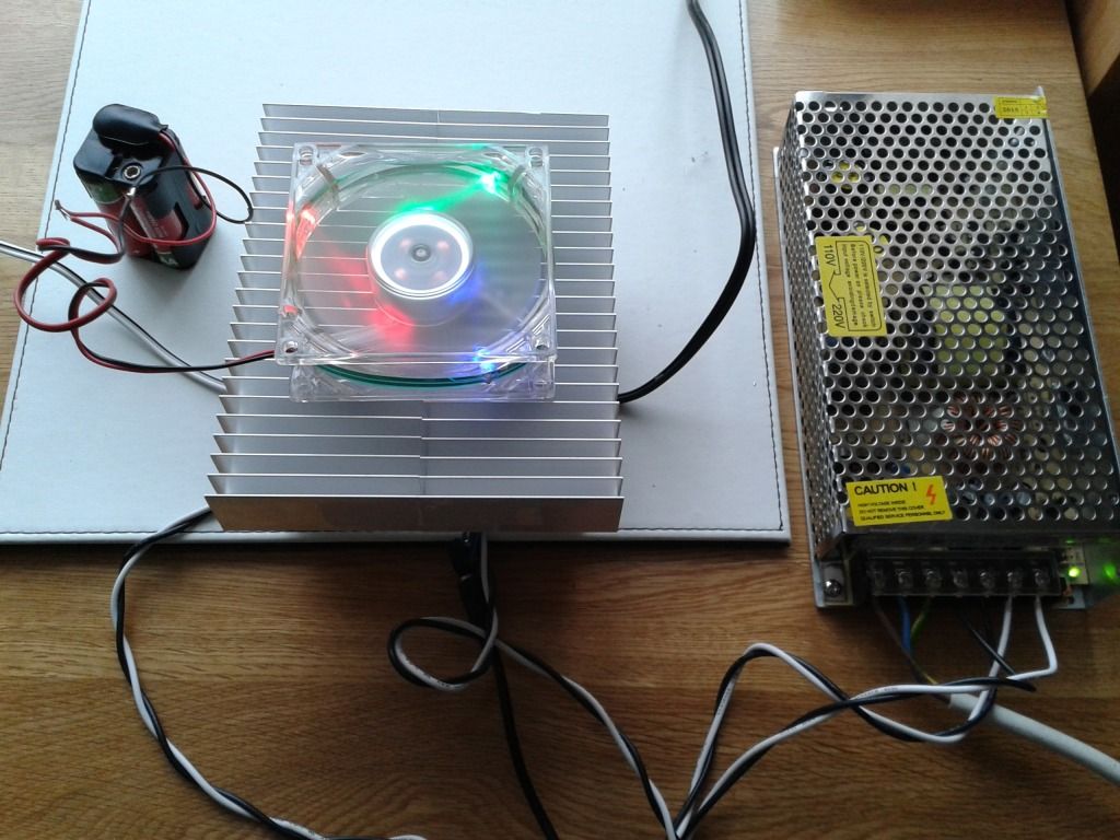

Thanks for the info Andrew. I realise the heatsinks are inadequate but it's what I had at the time and they're fine for while I'm experimenting. A PC case fan with natty LEDs keeps it cool while it's powered up. Runs off a 6V battery pack and it's completely silent. (may also experiment with a couple of CPU coolers)
