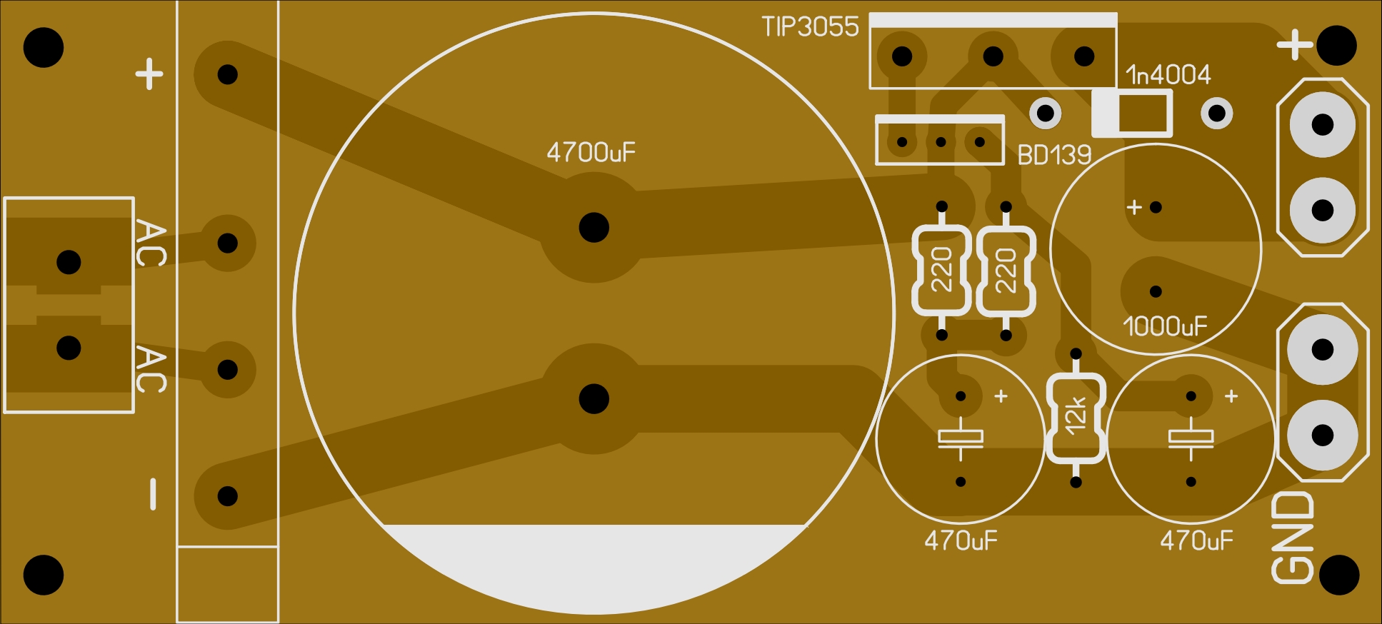

You guys got me curious So I looked up ESP's cap multiplier and drew a quick board to try it out. See what you think.

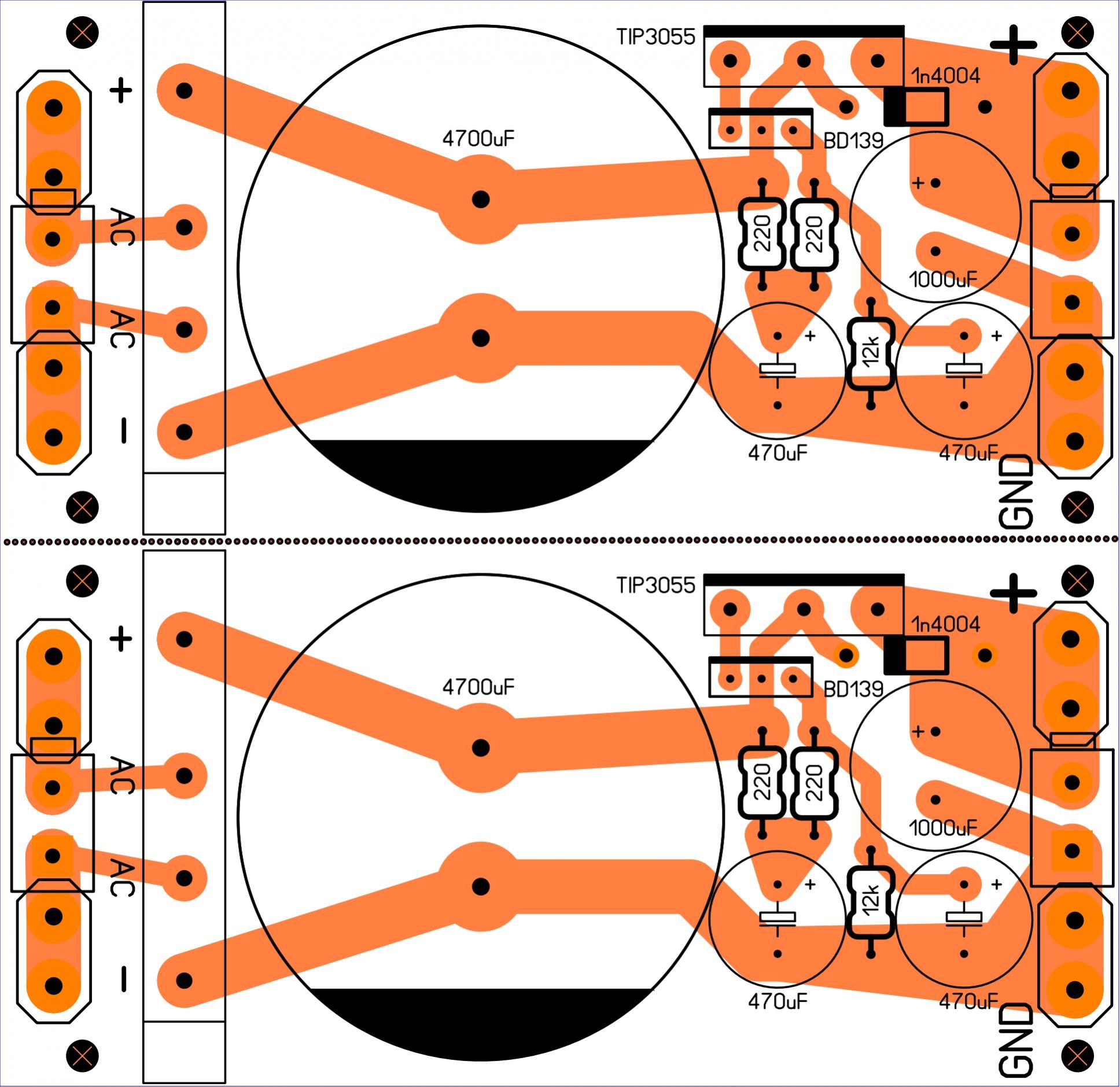

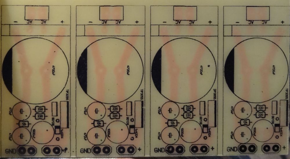

Nice boards, maybe you could upload files/pdf, so we could etch our own boards?
Sure. I worked it over a little to add some more copper and added Fast-on and euro style connectors to both ends of the boards. I also added holes to form a scribe if the boards are bought from a board house so they can be split. This is for iron transfer. Let me know if you need photo etch instead.

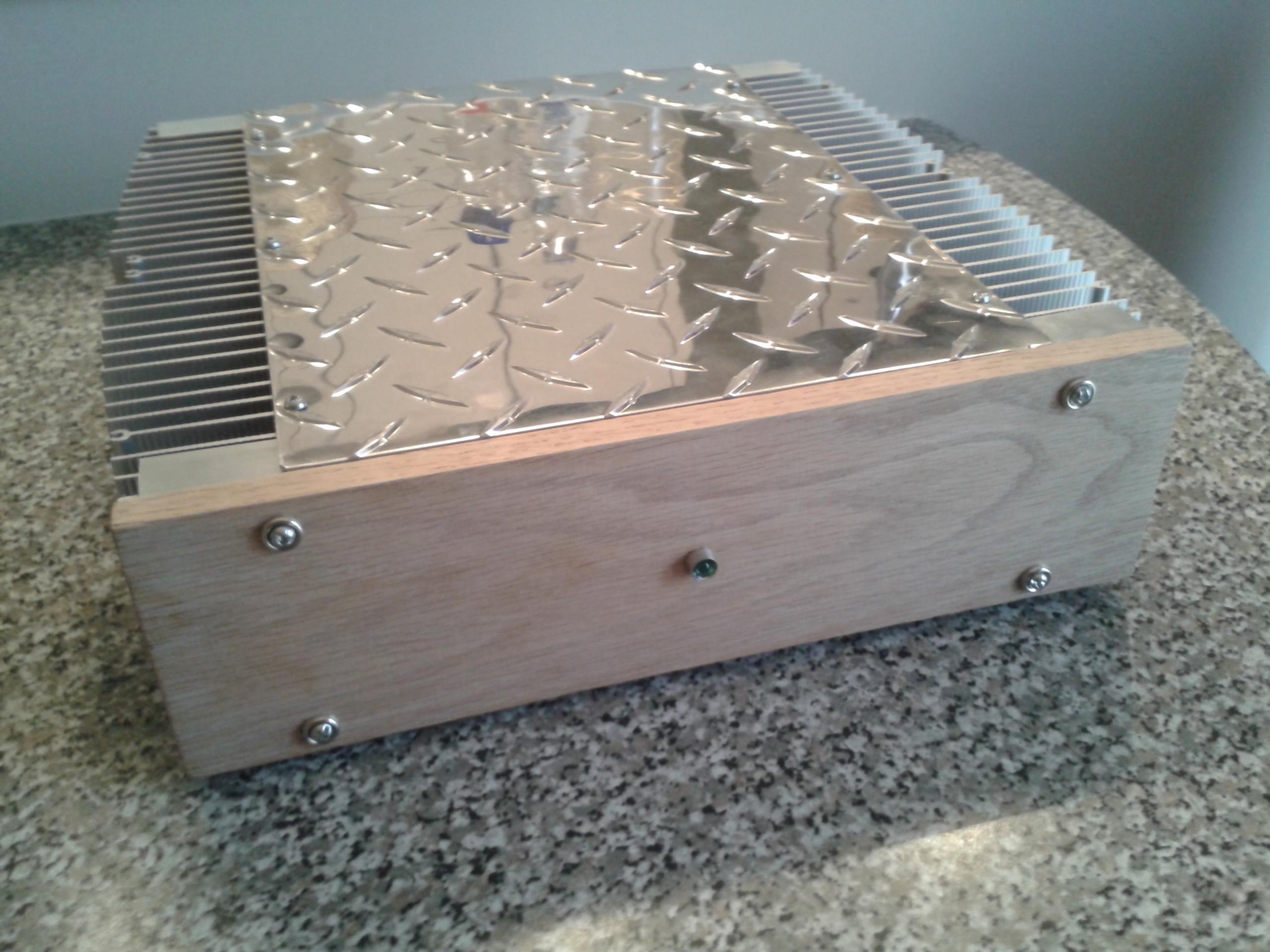

Exemple of heatsink
If you can tolerate a max heatsink temp of 50C based on an ambient of 25C, it means a rise of 25C max. So 25C/35W = 0.7C/W heatsink per channel. The one I use are each rated 0.55 C/W which is a smaller number meaning a bigger heatsink, the one shown on the picture are 12 inches deep x 3 inches high and 2 inches wide fines. My bias is at 27V, 1A therefore 27W. Each heatsink are at about 40C once warm.
