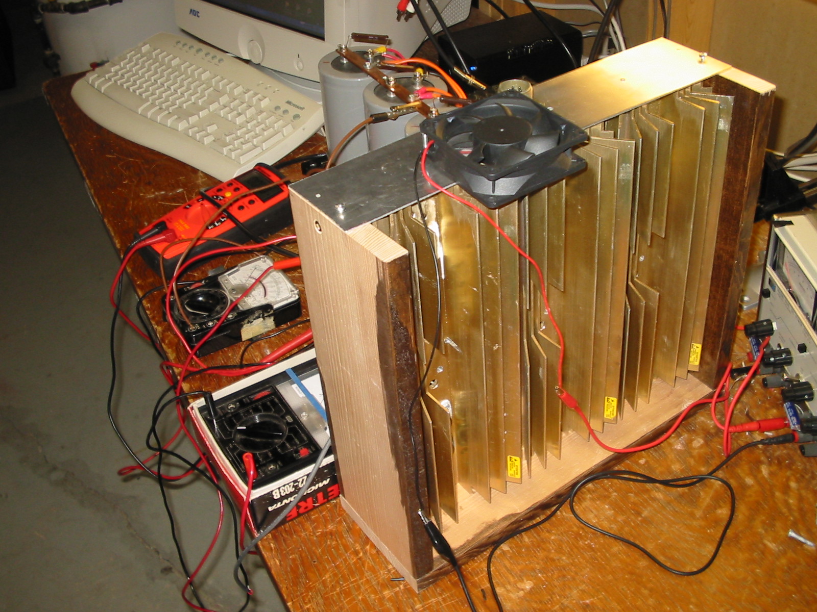

I am planning to build the high power version of JLH soon (just got my boards from Skycoral) using 2SC5200. I am trying to estimate how big a heat sink should one use (as a start, I plan to set the rail voltage at ~28V and Iq at ~ 2 amp). By the way, what kind of size of the heat sinks are you using? Thanks!
Here's a look of the heatsinks I used. I ended up using fans to use them oriented horizontally, they should be vertical (as shown in the picture) for best performance.
Basically, use the biggest heatsinks you can get. And they'll probably still be too small.

with all that woodwork (insulation) around the sinks you are reducing the heat dissipation capability of your sinks.
Is that fan blowing or sucking?
It should be blowing and it should be mounted at the bottom.
You would do better building a card, or plastic, or metal tunnel to divert the fan flow through the sinks.

Hi, Paulb,
Interesting. Are you putting all 8 output BJT's on that heat sink or just 4 (one channel)? I was also thinking using force convection since it is easier to get "narrower" heat sink in whatever length one wants. Place them horizontally face to face and then block the top and bottom to form a tunnel. Place a 120mm or 150 mm fan blowing from one end. Some of these fans can operate very quietly. I suspect this set up should work OK without the resort to huge heta sinks. However, such a design renders the whole amp "packaging" kind of awkward since the left and right channle are now physical divided by the tunnel. I have to build them in dual mono configuration which will jack up the cost.
Thanks for sharing your design.
Andrew,
I'm aware of how to get the most dissipation out of heatsinks, thanks. I'm hoping to do without a fan at all. In the orientation as shown, I didn't need a fan. My prototype as shown ended up using three of them because the box had to fit into a shelf and laid down horizontally.
Lo_Tse,
The three heatsinks were for two channels, 8 transistors. I added a thermal cutout that shut off the power if the heatsink temperature got too high - highly recommended.
Paulb,
Well, my guess from your picture - your heat sink should be around 12" x 10 or 12". Assuming each transistor generates 30-35 watt of heat, you have 8 x 30/35 = 240 to 280 watt to disspiate. Wow, I can see the heatsink would get pretty hot.
Good suggestion! Just curious, what kind of thermal cut out mechanism did you use? By the way, did you use the PCB from Skycoral or you made your own?
Regards
Going from memory (the amp isn't hooked up at the moment) I am running it at about 1.5 amps bias per channel at around 25Vx2, so 75 watts per channel; 150 total. The thermal cutout is a standard device you can get from Digikey or wherever. My power supply was controlled by a relay that was disconnected when the thermal cutout, well, cuts out.
I got my PCBs from Olimex using a design from Geoff Moss (the Class-A amp site guy). I still have the Gerbers etc. if you want:
