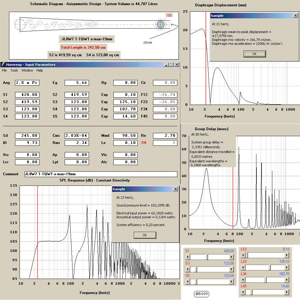

I recently acquired a JL Audio 8w7-3 and a 300W Bash plate amp. I'd like to build an enclosure for home use. From what I have read, a vented enclosure is preferred to a sealed when used in a home application. Makes sense since cabin gain is a factor in auto use.
Has anyone built or have experience with this design shown on drmarksays?
http://www.drmarksays.com/wp-content/uploads/2008/07/jl-audio-8w7-3pro.pdf
Scott
Here is a link to photos of the home subwoofer I built using the 8W7-3 data provided by the Dr. Mark site.
Flickr: scitizen17's Photostream
Very tight bass. Very powerful. In fact it's too powerful. It barely needs to be turned up at all to fill out the sound.
If anyone has an 8W7 laying around, and needs a home subwoofer, I can definitely recommended this design.
I can post the dimensional data if there is any interest.
Scott
