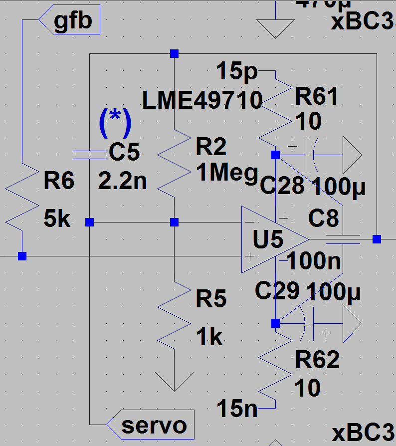

I use a little trick i learned from Bonsai.
Use 22 Ohm resistors in series with PSU plus and minus and decouple with 220uF each.
I then use only one 0.1uF foil from plus to minus for HF decouple ( Self ).
That way you improve PSU rejection in the treble where PSSR of the opamp gets worse.

Where do these 0.1uF go ?
plus to minus near the opamp Voltage inputs ?
as used in my power amp
So I got it right
This will be a blast
You did not got it wrong say no more...
