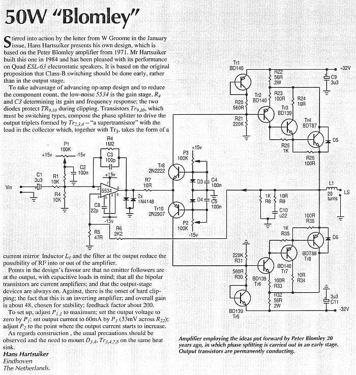

Another opamp driven power amp.
R22, R32 look suspicious.
It think it must read R56 so 0.56 Ohm.
See also http://worldtracker.org/media/libra.... High Performance Audio Power Amplifiers.pdf
And here https://www.flickr.com/photos/suikerbuik/with/3944876995/
This may be related http://www.google.com/patents/DE19637292B4?cl=de
And this one http://www.keith-snook.info/wireles.../New Approach to class B Amplifier Design.pdf
And yes, the 56R must read 0.56R (Dutch design, best design )
In link 4 we have our wingspread in 1971 so this goes back a long way.

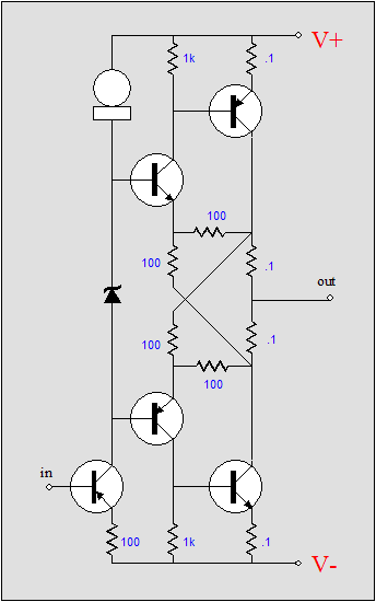

I have also been occupied recently by this matter of linearise the CFP output stage. but I follow a different route.

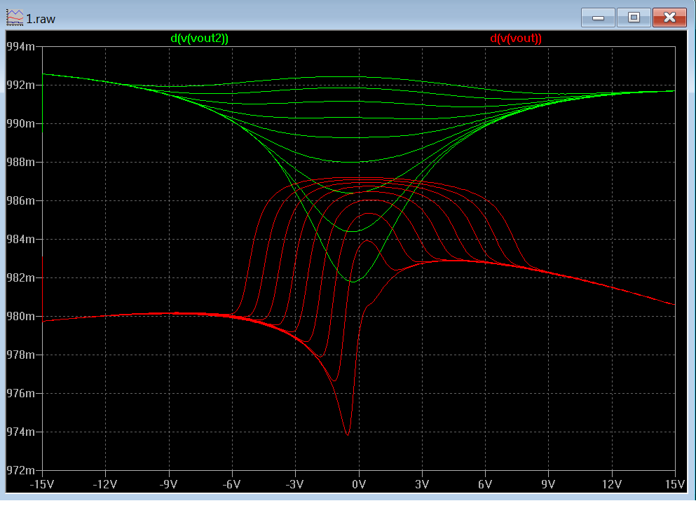

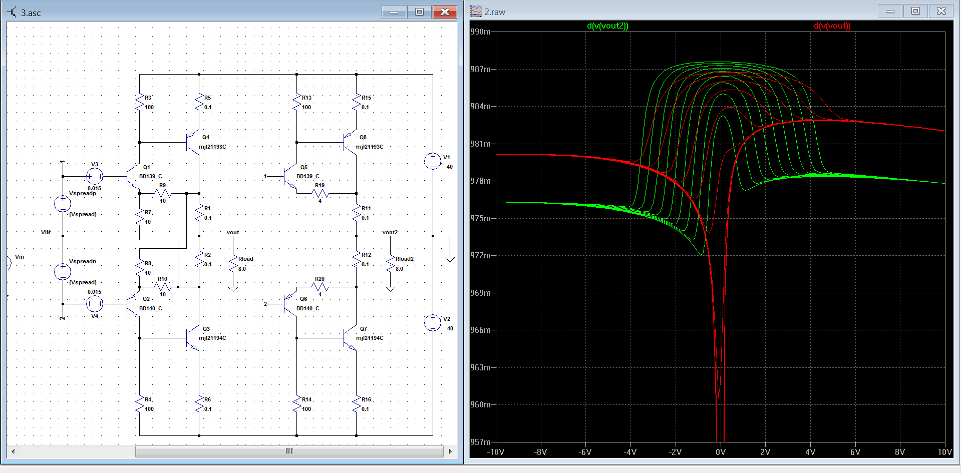

I will simulate the circuit that you post, and will post the result.
The wingspread of the #568 circuit does not show a great improvement , the gain is higher that the simple CFP but it has lower temperature stability, the resistors values used in #568 are also very high unless the power transistors are darlington.
It has also the gm-doubling effect as the normal CFP.
This is the wingspread of the CFP that I have been developing in green, against the circuit from #568 in red. The gain is even higher and there is no gm-doubling, the temperature stability is better than the simple CFP.
The upper traces are at quiescent current of 350mA.
I am designing a pcb for a amplifier with this output stage, but until the end of the year will not have any time left for further developments.
