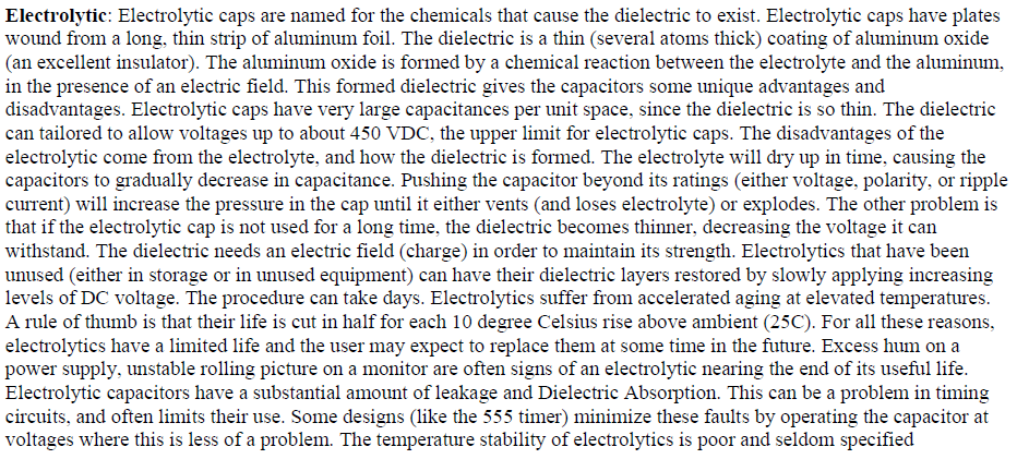

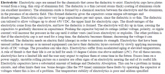

You followed my thoughts.... according to the text below, EL caps dielectric exists due to a reaction between the electrolyte and the alu foil when they are submitted to a polarizing voltage.
If the polarizing voltage does not exist (long stored caps) the dielectric layer gets thinner.... it seems EL caps really need a polarizing voltage to work as intended.... Torsten's idea seems to cope with it.....
Anyway, I will revert the links so caps will be connected minus to minus as it seems to be everybody's trend.

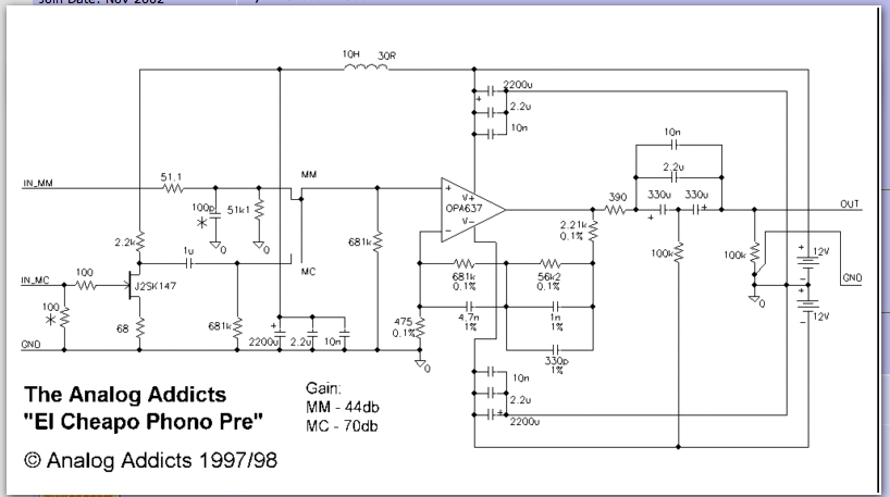

PS: Just found some nice small bipolar black gate caps (47u).... how low can the voltage be in the feedback loop ? I want to use those little 6 volts BG instead of the double 100u in the feedback chain.

I think the voltage that develops over the electrolytic is the maximum voltage that the amp can deliver devided by the feedback factor that works like a voltage devider.
I do not know if there is any inrush peak.
Maybe Frans knows. 6V is low though.

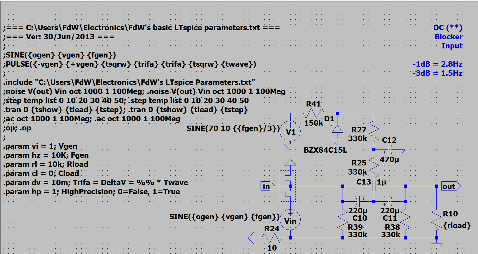

For the amplifier I am testing something like this, what do you think of this?

I think 6V will do, but I would advice bipolar (see also my previous post)
So you use an extra V1 to create a polarizing voltage in the bipolar cap.... complex but very interesting.
Yes, this all due to the fact that I have my doubts about long term stability (and I want to use 500 to 1000uF coupling caps).
The polarizing voltage here is created from the 70V main supply. But it can be taken from any supply. Due to the nature of the application there is no current (other then the capacitors leakage) in the circuit, all resistors can be of high values. A filter R of a few 100K and C of a few 100uF can be used to power the polarizing source. This will be quite stable.
Also using very high R's will reduce any on/off plop's (has to be tested) (I think) (and there I am at the moment).

The question is, how does the dielectric develop over time if the differential voltage is about zero volts (when used as a low signal input capacitor). And what is the difference between polar- and bipolar devices?
It seems to me that 'forced' polarization (as in the proposed schema earlier) will solve most 'unknowns' and that is what got me interested (To be continued ).
