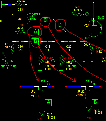

I built a 2-channel tube amp using 2N5638 JFETs as switches, first time using them. The switches turn on and off seamlessly but I have distortion and attenuation problems, I think because the signal swings ~1-2 Volts, plus or minus...

The 'correction' will be not to use SS devices as 'mute switches'. Their non-linear capacitances make for horrid sound. No BS, use a relay if you must mute the output.
(One of the best and most audible mods I've ever done to commercial gear was to remove the muting transistors on the output of a CDP. Better to have a little 'thump' than have these muting devices.)
You forgot a couple of resistors. You need DC path through resistor from gate to source to discharge it when the switch is "on". Also, you need DC path to ground from it's source. But now you have a problem with some DC on output. To solve this problem you need more than one JFET for the switch, like "T" of 3 JFETS, couple of horizontal and one vertical controlled by inverted levels.

Yes,
47K from input to gnd (or some DC path)
47K from output to gnd (or some DC path)
1M from gate to control V
control swings -13V to +13V
But Wavebourn is correct, a "T" configuration would insure a greater "off" state

I am attaching the image of the JFET node in the preamp.

So if your points A,B,C and D are the points where you want a switch then I think it should work OK. All those points look ground referenced (no DC present)
The isolation of a single FET is very high (at DC its virtually infinite) and at AC it is due to capacitive and junction capacitance so you may only need a single FET rather than a series shunt arrangement anyway. In my preamp I went for maximum isolation between different signal sources but thats not an issue here.
One question is what the peak to peak signal levels will be as that has to be within the acceptable and allowable range of gate-source voltage to the FET. For example if you turn the FET off with say -8 volts then that means that signals that exceed that level will break through.
The control voltage is a bit higher that that, its at -13.66 VDC. The signal is at around 2 Vpp, so when the JFETs are off no signal comes through. When the FETs are ON, however, they fluctuate, since there is no signal offset to the Gate voltage, which is at 0V when ON.
So, do you think the addition of a diode from Source to Gate would give that offset I need?
J111 & J112 are ideally suited to FET switching. If the source is treated as the input then it should be strapped to the gate using ~22k to ensure that Vgs remains @ 0V in the presence of an input signal. These FETs are apparently symmetrical.
You must drive the FET's via a resistor. The diode leaves the gate floating which is no good. Make sure that -14 volts is within the G-S rating of your chosen FET. (I could use much lower "on" drive voltages than you because of the virtual earth opamp).
I used an arrangement whereby the discrete "logic" driving my FET's ran on an -8 volt rail and for "FET on" was clamped to a 0.2 volt rail proveded by a forward biased germanium diode.
