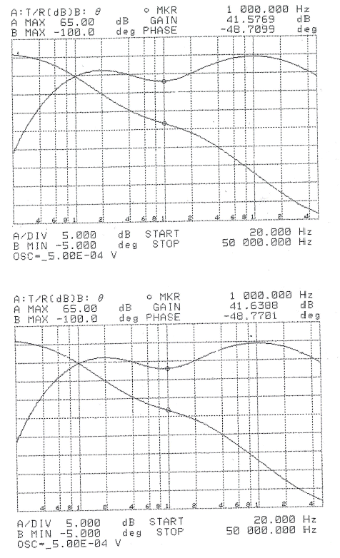

Everything is working now, for the time bein using Vishay PN4393 in the first stage and Fairchild PN4303(I decided to live dangerously) in the second stage. Attached are the gain-phase plots for the two channels, showing good matching. Good sound? That remains to be seen. The gif file is a little large (99k) but hopefully not too taxing on folks.

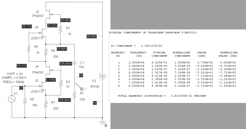

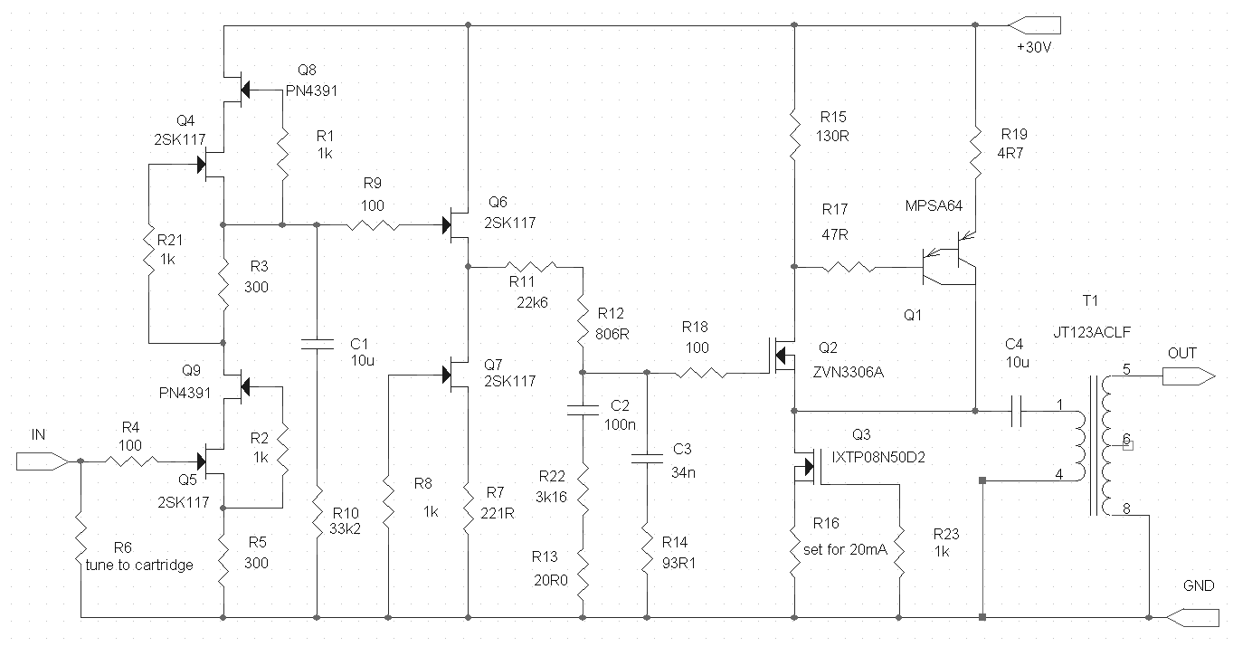

Here's a New Year's present to think about. Using a high-gain fet like the 2SK117 in an SRPP stage allows one to get most of the gain needed for a MM phono cartridge in one whack, in this case, about 300X. Distortion is not too shabby at max signal, being around 0.07%, mostly 2nd harmonic. It's correspondingly less at lower amplitude (who runs their system at full-clip levels, anyway?). Cascoding the SRPP in this case is imperative because of the high gain, so I'll have to solve the balancing problem I'm seeing in cascoded SRPP stages - it may just be a matter of closely matching the cascode fets as well as the gain fets. After a passive RIAA filter, a power buffer drives a step-up transformer for another 4X gain. This isn't something I'm going to hop on right away, but it does provide food for thought. Another approach might be to replace the buffer/transformer with the buffer-with-gain circuit shown in the "Liniac Revisited" thread.
Here is the sim data for the 2SK117 cascode SRPP. The capacitively coupled SRPP load resistor sets the overall gain at 400X, which is a good match for the Jensen output transformer (3X) to arrive at 40dB gain at 1 kHz, suitable for the usual MM/MI setup. Those worried about overload, seeing that most of the gain is in the first stage, could use a higher rail voltage for more headroom. This is starting to look interesting - I may actually build this circuit when I get a few other projects out of the way. The IXYS depletion mode fet used in the current source for the output follower could probably be replaced with a Supertex DN2540N5 depletion mode fet, a part a little easier to source.

I am wondering about the application of the output transformer. The price is maybe 2 orders of magnitude greater than the JFETs. Is there a silicon way to due it without the expensive iron?

Use the output buffer with gain that I mentioned. It has very low distortion, and has been making nice sounds in my home system for close to a year. The costs are lower, but you give up the galvanic isolation of the transformer. Also, with the transformer you could do a balanced output if you felt like it.
I can see two cascoded jFETs (117) in the front end.
Yes, that's what I said as part of my questions.I think that there are 2 cascode fet cells J5,J4 & J6,J3.
