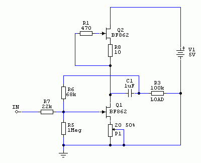

Ok, re pinch off...I thought it would be more dramatic, but with a VGS of -1.9V, the voltage drop across the drain's 100r resistor sees a chunky drop, but there's still a bit of current flowing (with VCC of 5V I'm seeing about 100mv across the 100R resistor) ...it's not until VGS of about -2.5V that there's no IDS current flowing at all (no voltage drop across the drain resistor) .....I'm assuming that cutoff voltage should be deemed -2.5V here?

Now measure pinch off voltage. Put a 1 megohm or so resistor between source and ground, and ground the gate.
What voltage do you read at the source?

Don't estimate pinch off. Just turn up your source resistor (how high can you go?) and read the voltage at the source.
I didn't estimate it...cranking the variable 60k of resistance (which was all I had immediately to hand) in the source .........at a source voltage of 2.5V there was no current flowing (no drop across the 100R resistor) ... therefore pinch off equals -2.5V
So if I've an IDS max of 4.9mA...should I be shooting for 50% of that for biasing purposes? (which would then mean I'd need to find the gate source voltage that yields an IDS current of about 2.5mA (or 250mV drop across the 100R drain resistor)
Edit: for a 250mV drop across the 100R drain resistor sees a 2.1V voltage on the source - so is this my biasing point?
Look, you do not have to read the current flowing. Just crank the source resistor up to max (the voltage will not go higher than pinch off) and read G-S voltage. Much easier. And less error prone, in case your voltmeter isn't that sensitive to measure such low voltage drops.
OK, let's say -2.5V is ok. Now, you can bias the JFet with your pot at say V GS = -0.75 V, i believe this will give around 2.5mA at operating Point. That means approx. 300 Ohm source resistor.
Check if this is correct please.

ok, with the source resistor cranked up, I see a source voltage of 2.54 (top tip - thanks)
Where did you get the GS 0.75V = 2.5mA ID figure from?
300 ohms in the source sees a 1.92V drop across the resistance ...which is an ID of 6.4mA - this is puzzling as that's higher than my earlier measured IDS max of 4.98mA?!!!!

[....]Where did you get the GS 0.75V = 2.5mA ID figure from?
Quick calculation....
IDSS=5mA
Vp=2.5V (V pinch off)
Desired V GS = 0.75V (so you can swing between VGS of 0.25 and 1.25, Vpp=1V)
ID at VGS = IDSS * (1- VGS/Vp)

I see the methodology now - thanks.....but how to decide on the drain resistance?

I quickly checked the datasheet (always read them, you see now why!), J110 has a minimum IDSS of 10mA.
You have to repeat the measurement of IDSS...
[...].....but how to decide on the drain resistance?[...]
As soon as you have ID settled at the operating point (let's say it's 5mA), you can calculate the mid point (i.e. at 0V input).
To swing 3Vpp, you should aim to around 2V below rail = 3V. So you will swing from 1.5V to 4.5V.
With 5mA and 2V drop, it's easy, isn't it? 2V/5mA = 400 Ohm.
BUT, i fear with 400 Ohm, you won't get any gain.
Gain of a common source amp is Rd/(1/gm+Rs).
But let's see what you find out regarding IDSS.

Because I want to square JFETs away in my head (& I'm a long way from that at the moment!), I will revisit today, but that earlier 100ma IDS measurment was with the gate grounded, the source grounded & 5V applied to the drain (no resistors in situ at all as I wanted to establish the max IDS)
In fact just double checked the measurement & it is showing 120mA....therefore I guess we can summise that the JFET 'on' resistance is 41 ohms?
120mA for Idss, has the device failed to a dead short?
With 10Vds that is a dissipation of 1.2W !!
I'm applying 5V across the drain source
And how did you measure the current? With an Amp Meter? Or do you still have the 100 Ohm resistor between 5V and drain? With 100 Ohms and a 5V supply, you can't be measuring 10V (10V / 100 Ohm = 100mA)
Put the 100 ohm resistor back, increase the voltage to 10-15V, and measure again....
because the 100 ohm drain resistor (as recommended by that article I linked to earlier), seemed to really give me out of whack results....I removed the drain resistor completely...essentially the 120mA reading is with my DVM (ie current setting!) slotted in series between source & ground....no resistors, gate grounded, 5V on the drain.
