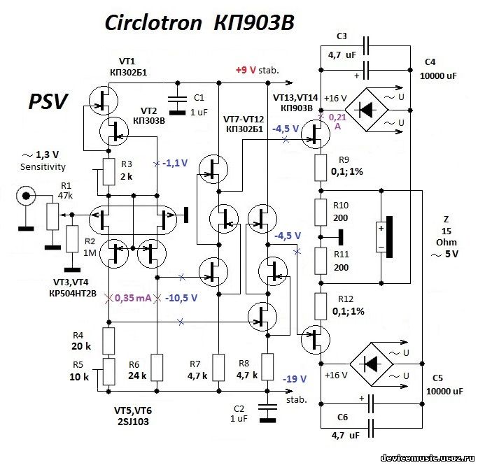

Designed to isodynamic-orthodynamic headphones.
Maximum on the output power of 7.5 and 15 Ohm - 1,7 W, 100 Ohm - 1,06 W.
The output impedance of 3.3 ohms at 1 kHz at a voltage at the output of 2.5-3 V.
Band power at a voltage of 90% of the level of restriction is longer 200 kHz.
With a downturn in the upper frequency (200 kHz) of less than 0.5 dB.

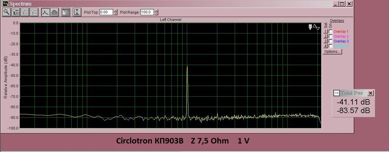

What is a circlotron, and what advantage is there in this type of amplifier for powering headphones? What is the part shown as a diode within a 4-sided diamond? Other than that part, I might not have too much trouble in building it, although the part number of JFETs that I could easily access would start 2N.
What is a circlotron? Check here: https://www.passdiy.com/project/amplifiers/build-the-amazing-fet-circlotron
That's a four diode module, and there are many kinds. A random example:

Thanks for filling me in. In your post #5, you are saying that substitute JFETs would have to closely match the characteristics of the JFETs making up Svjatoslav's Circlotron, is that correct?

Yes, I would recommend using the same types to avoid headaches.

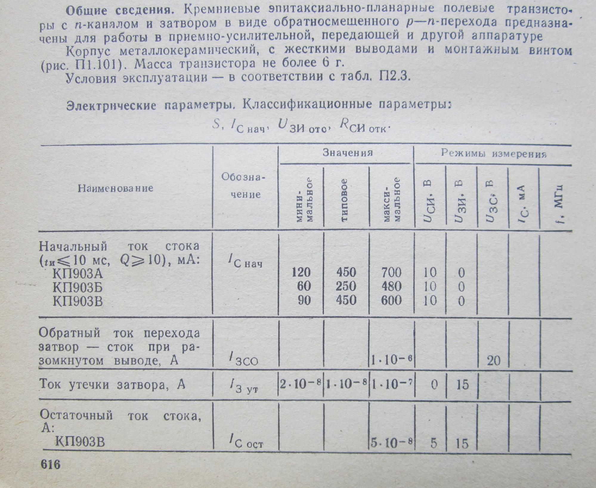

There is a rough equivalent in a non-Russian part - that is a high power JFET made in Russia, surplus stuff these days. Fairly rare, and hard to source regardless. They do show up on ebay. Probably the best way to get some, since you only need a handful for a headphone amp.
The reason for the Circlotron is that there are no complimentary parts for this device.
To find the USA made equivalent you'll need to do a bunch of online research looking for power Jfets made 30-40+ years back. I did locate the part number years back, and you can source them, but they are fairly pricey IF you can get any. The Russian parts handle a bit more power, iirc.
I think the driver circuit could be made more simply, but a bit depends on what sort of result you're going for, and what sort of voltages need to be swung.

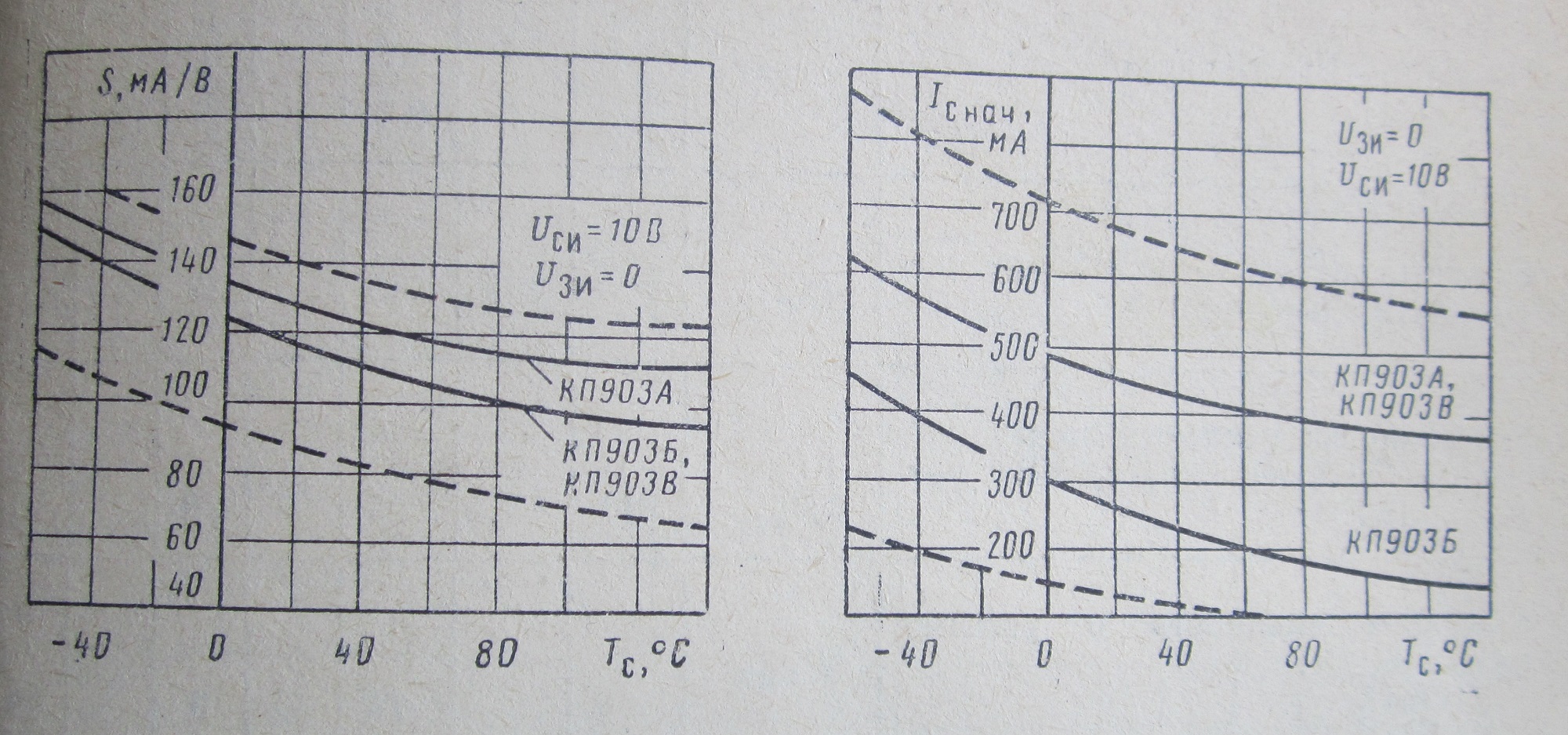

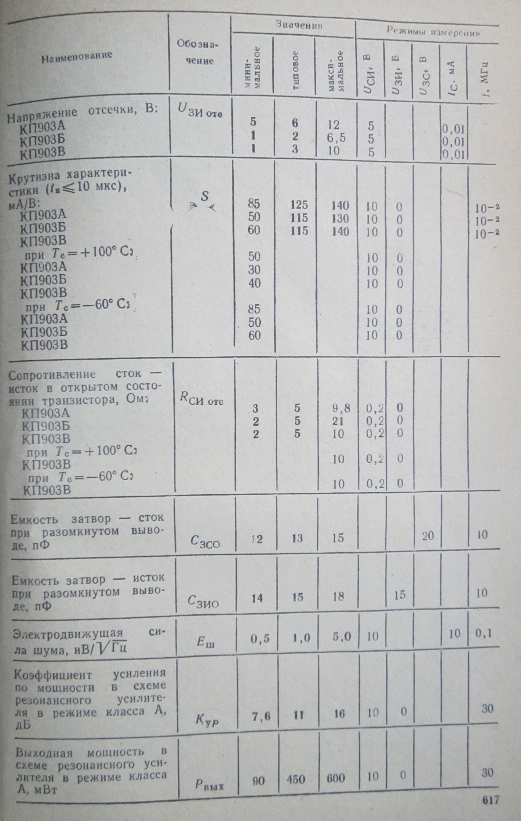

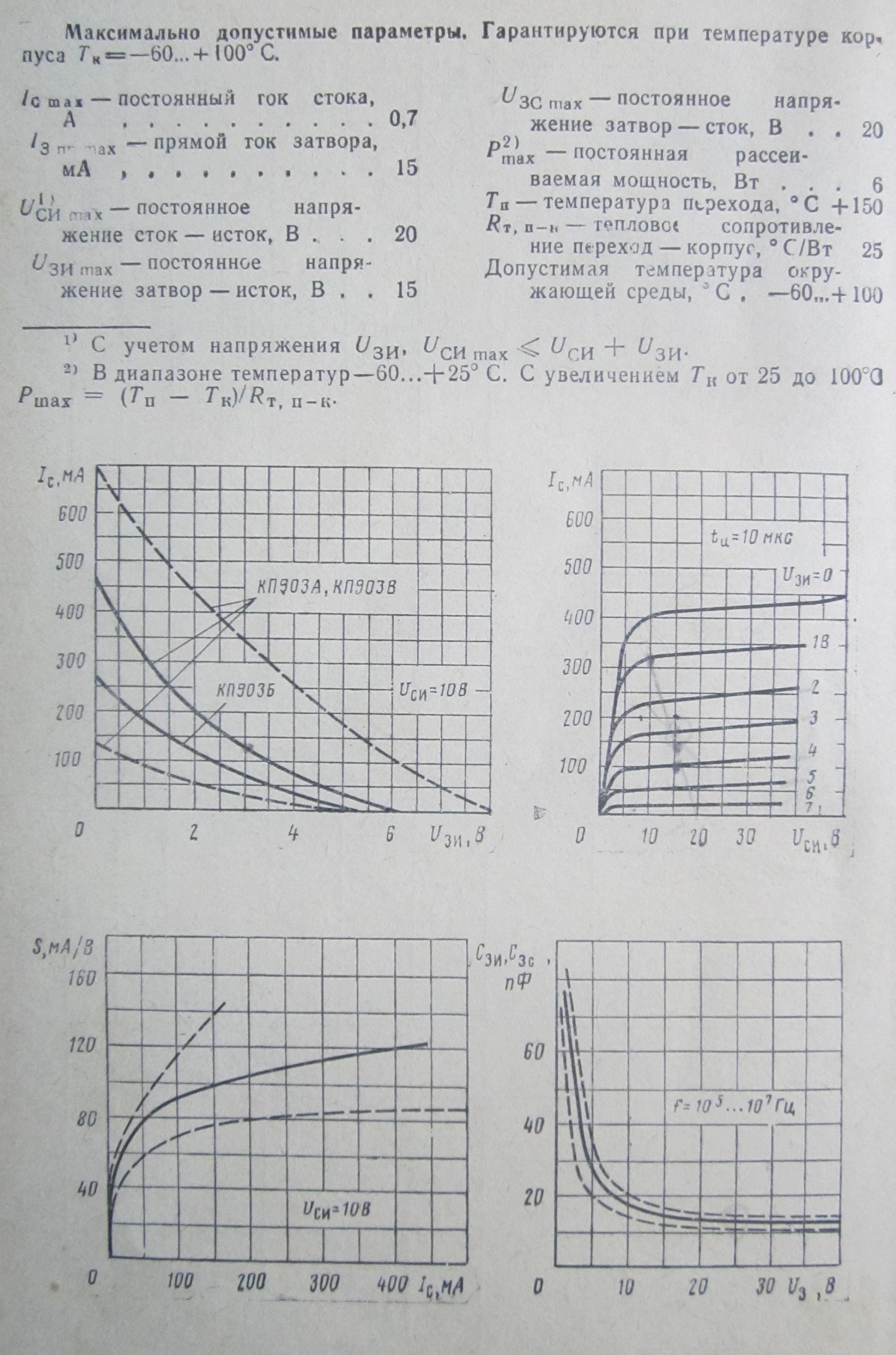

2П903А, 2П903В the same as КП903А, КП903В.
With the letter "Б" less current.
There are in the housing, "white", there are "yellow".
Output current (150-200 mA) keeps very stable.
Zero output - too.
Without transformer tube also holds good mode:
http://www.diyaudio.com/forums/full-range/218603-speakers-full-range-high-resistance-4.html
Zero output - too.

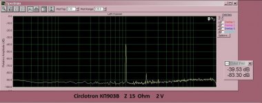

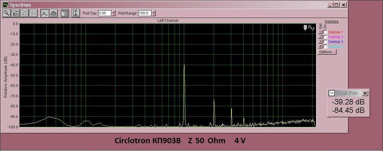

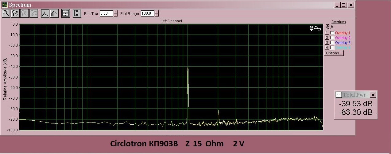

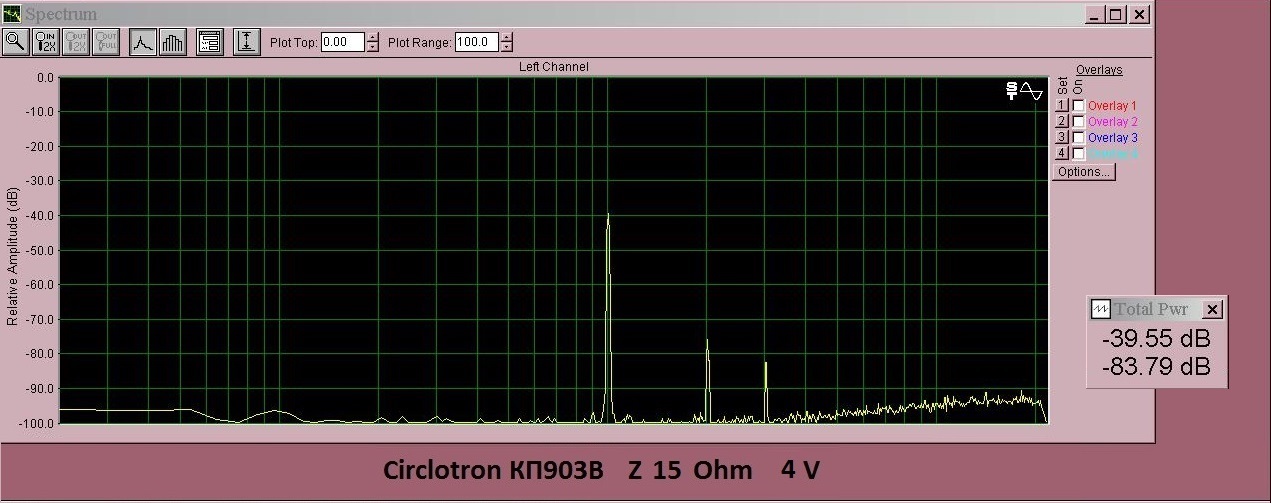

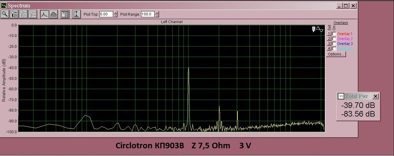

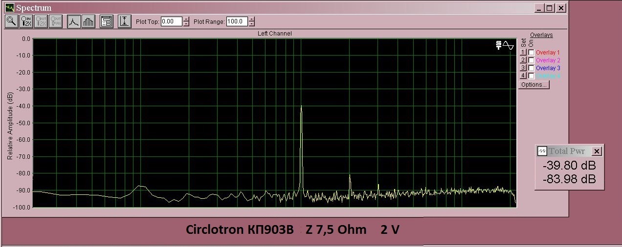

It would be nice to see the FFT plots with the sensitivity of the measuring device/input attenuator set so that the peak of the fundamental was ~6dB of "0", so that the harmonics might emerge from the noise floor?

Thanks for the datasheets!!
I was unable to find them online some time back - but I do not speak/read Russian.

My comment was that IF those are actual measurements (??) and not simulations, that the level of the fundamental was ~-40dB, so the resulting information is all in the noise floor. This makes it of very limited value.
But since I have some of these devices, I am following with interest.
