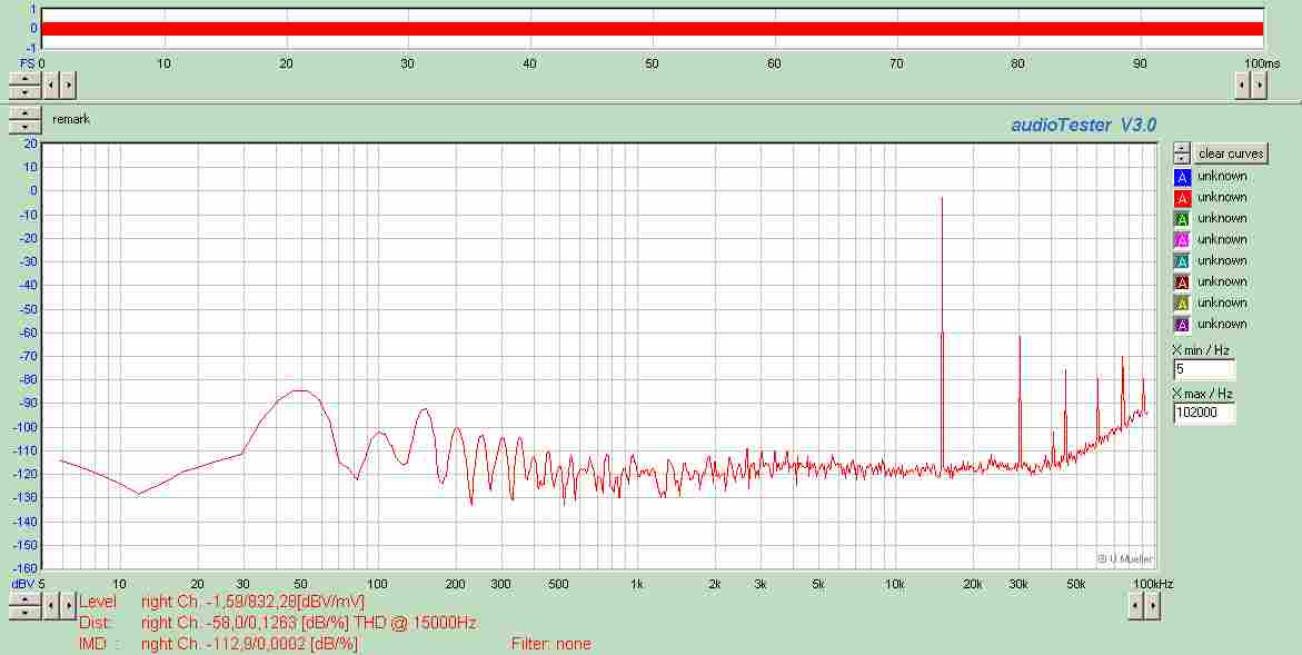

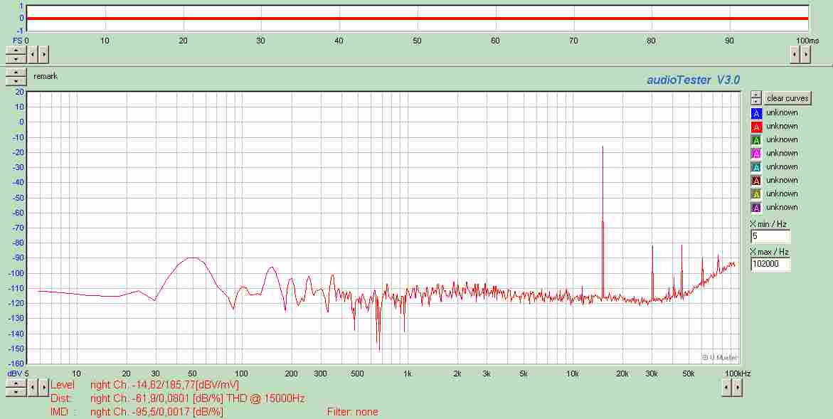

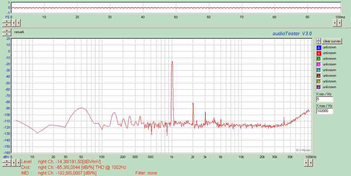

Sorry for mess, but I have sen you a link to the wrong measurements... To many projects are going on in parallel. Here are correct measurements:

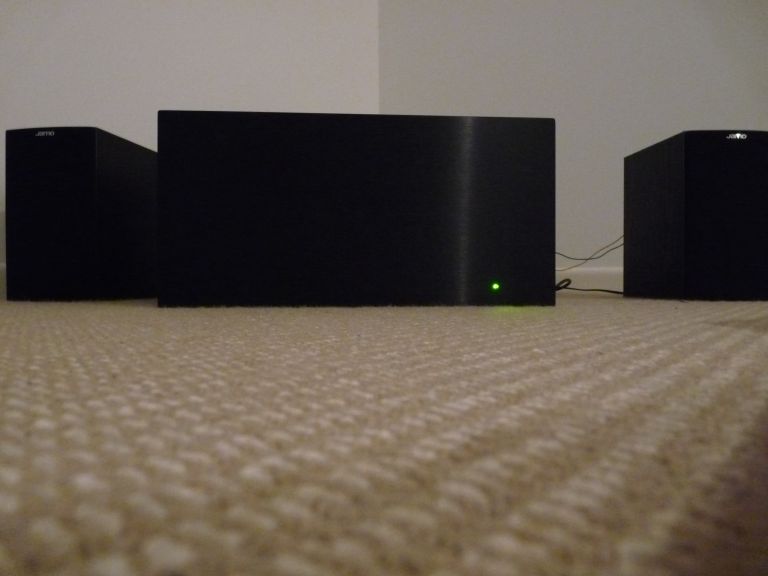

Um, some of them are 🙂 🙂 Here is my new build, completed tonight and undergoing initial listening with cheap bookshelves...cooking away at 1.2A bias.
Having built an Aleph a year or so back I think this thing would hold its own at the burning amp festival!
Listening to Ennio Morricone's "The Mission" soundtrack. It's something else!
