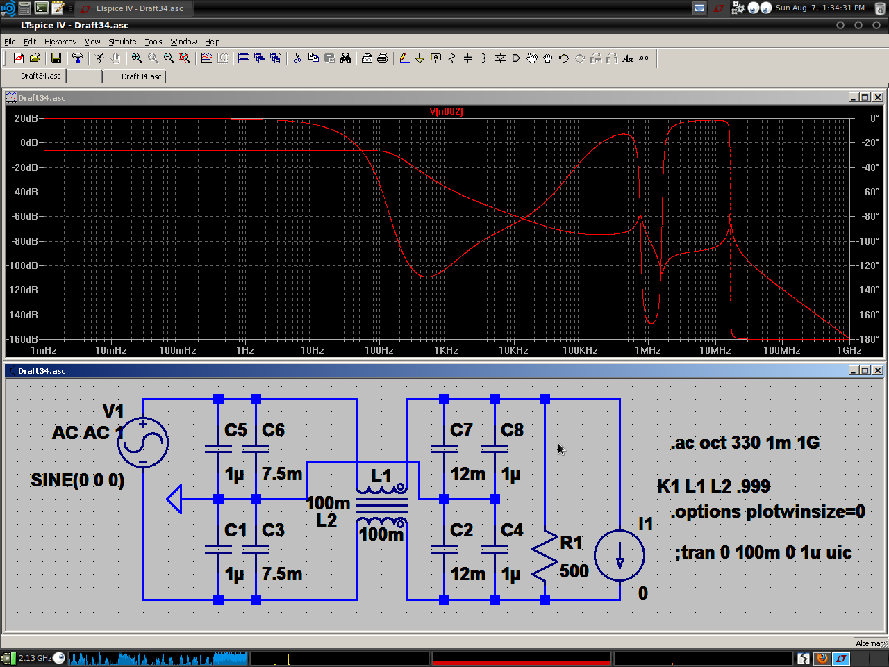

Mike,
There is a way you can use a common mode choke - which can be viewed as a 1:1 transformer in fact - on the supply rails between the filter caps.
This component creates a mutually coupling magnetic circuit which nulls noise appearing on both rails, just as KT has drawn it. So, a current pulse on one winding, say serving the positive rail but also appearing on the negative rail, will be transformed into a magnetic pulse which depresses the current pulse on the other rail, and vice versa. These are very effective, and I use them on one of my commercial amps. Coilcraft make these small chokes - strongly recommended.
Are you using about 5mH?
Hugh
Hugh
Hi Hugh,
My chokes are just like in KT's diagram only I use them in the earth legs also just like your CRC arrangenment published earlier in this thread.
I would be interested in small because although my supply is now very good indeed it certainly isn't either small or light or cheap. Thanks for that I will check their site.
I am using 12V + 12V as 1:1 transformer type mode as you describe the inductance is 3mH per winding which adds up to 12mH when they are operating in series.
I imagine that 15V + 15V would give about 5mH
cheers
mike

Correction:
My chokes are not in common mode - I may be a bit thick but for my purposes I don't see much point in common mode chokes as I explained earlier. KT said they don't act against common mode noise but it seems to me that is precisely what they do do and common mode noise is not as issue for me at present . . . . but perhaps I need a lesson in chokes coz I have heard people talking about common mode chokes for ages now and I never did really see what they are for unless on is trying to prevent noise with reference to an earth and my at present my entire system is pretty much floating with respect to earth.
