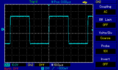

JFET input, MOSFET VAS, LATERAL output = Perfect!!
All,
I have just made yet another incarnation of this amplifier that I think looks very promising. You may recall that I wasn't impressed with the JFET front end and BJT VAS. Well that was when I thought I needed a lot more drive for the fets so I was using the BD140. This one uses the BC560, which I think the JFET will have much less trouble driving.
Note that it needs no compensation, just a very small output snubber to keep it clean with no load attached.
Check out that 20kHz square wave into a 8R load at nearly full power...perfect!
I need to get some more current through the jfet, but my current dual led bias arangement won't let me as I can't turn on the JFET hard enough to get enough current through a smaller drain resistor. Will add another LED tomorrow so I can get enough voltage drop across a smaller resistor (like 150R or so).
Anyway, will post listening impressions tomorrow. I think it could be quite good!

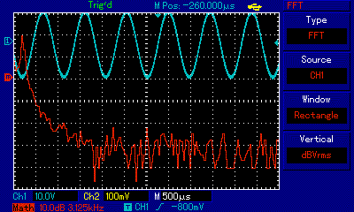

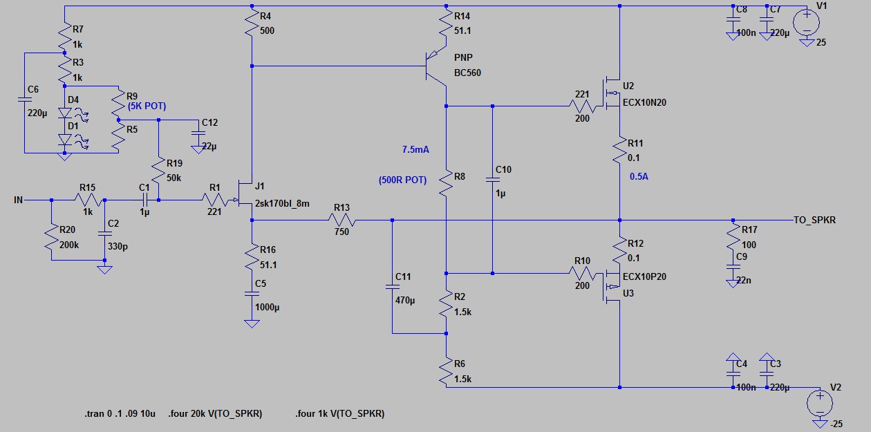

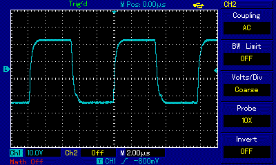

All,
Please forgive me for all the continual scope shots. I'm a scientist by trade and I love playing with scientific instruments. I hope you guys get as much out of this a I do.
The schematic I posted in post #1001 is looking very good indeed...on paper at least. I have dropped the jfet drainn resistor to 200R and added another LED to the bias stack. Oh, the input cap is 2.2uF too.
I did not think 7mA would be enough to drive the laterals that well, but check out the 100kHz square wave into 8R! Not bad at all!
Also attached is the 30V p-p 1kHz fft. Is this quite good for a lashed up amplifier sitting on the floor of my room with computers and other gear lying around?

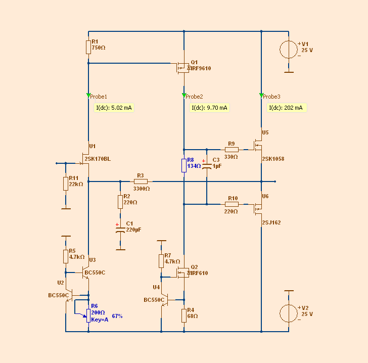

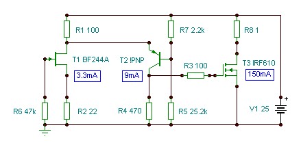

Schematic below is such an amplifier.
The feedback resistors are 3300/220/220uF.
I use no resistors for the IRF9610. No Gate, No source.
AC Analysis shows it should be stable without cap.
(2200/150 needs a small miller cap.)
I use IRF610 as Current source for the IRF9610 VAS.
This amplifier should have a good performance
and still probably a good sound.

Moment of truth!
All,

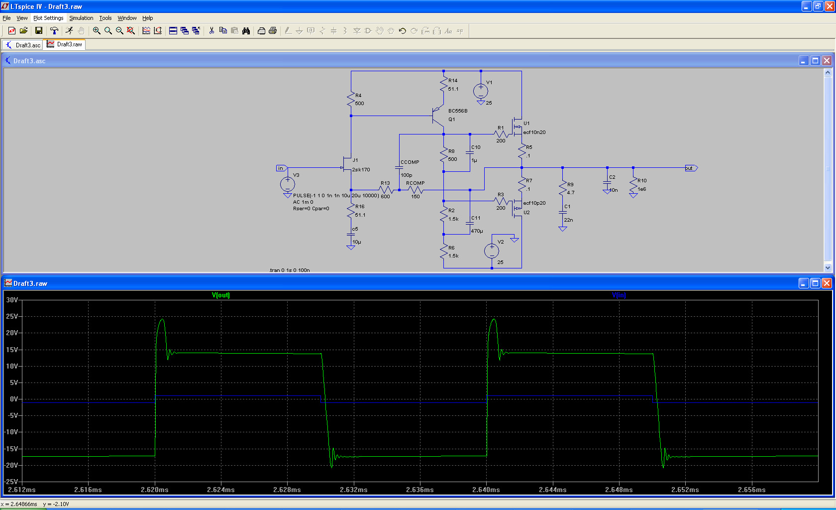

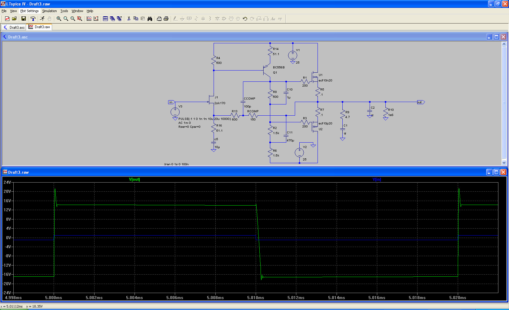

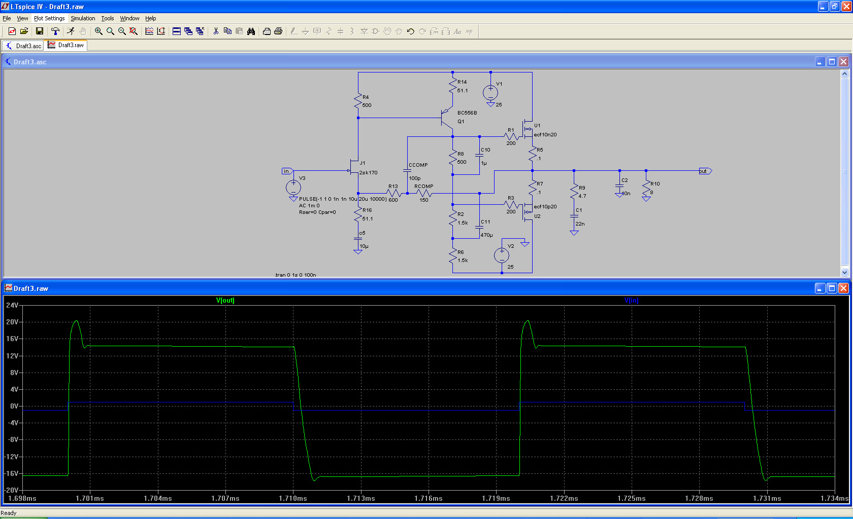

First of all, i am not trying to send the circuit to graveyard. :)
I have just put the circuit into the simulator. Or should we basicly.
I know that i have added input lowpass filter, DC voltage adjust, C5 is only 10uF and the Zobelnetwork is disabled (4.7Ohm + 1fF cap)
R13 is modified to 600 + 150R (RCOMP).
I have added a CCOMP of 1fF -> not active
I wanted to see how the circuit behave.
On the first picture the circuit oscillate and the load is 1MOhm pure.
On the second picture the oscillation is removed by adding CCOMP of 100pF.
The slewrate is assymetric in both sims and just little smaller with CCOMP added.
On the third picture the load of 10nF||8R is added + CCOMP of 100pF + Zobel is 4.7R+22nF.
The Zobel is needed to add stability into capacitive loading as SWF,
On the fourth picture the load of only 10nF is added + CCOMP of 100pF + Zobel is 4.7R+22nF.

Sonnya,
Interesting simulations, this is more or less exactly how the oscillation presents itself. However, the stability is much better than your simulation - 22nf doesn't faze it.
Also, won't all amplifiers with a single ended VAS have an asymmetric slew rate?
Going to go test the stability in more depth.
KP,
That 100KHz square wave indicates that driving the laterals ain't such a big problem. With a few pairs, and/or hexfets, yes, driving with an EF (like Workhorse, and in one of my amps, the NAKSA) is a good idea. In this case, horses for courses....

Sonnya, I think LTSpice tends to be very pessimistic regarding oscillation. Obviously the circuit doesn't oscillate this way in real life. Also you left out the gate stopper on the Jfet. SWF may have taken his tests with the input filter, I don't know if he removed it.
Also, add some .5R resistance to your supplies and some filtering just to make it more realistic. Add appropriate series inductances and resistances to all caps. Then the simulation may be more indicative of real life.

SWF, look at your square shots closer. I see some ringing on the lower corner. This may be unavoidable though.
