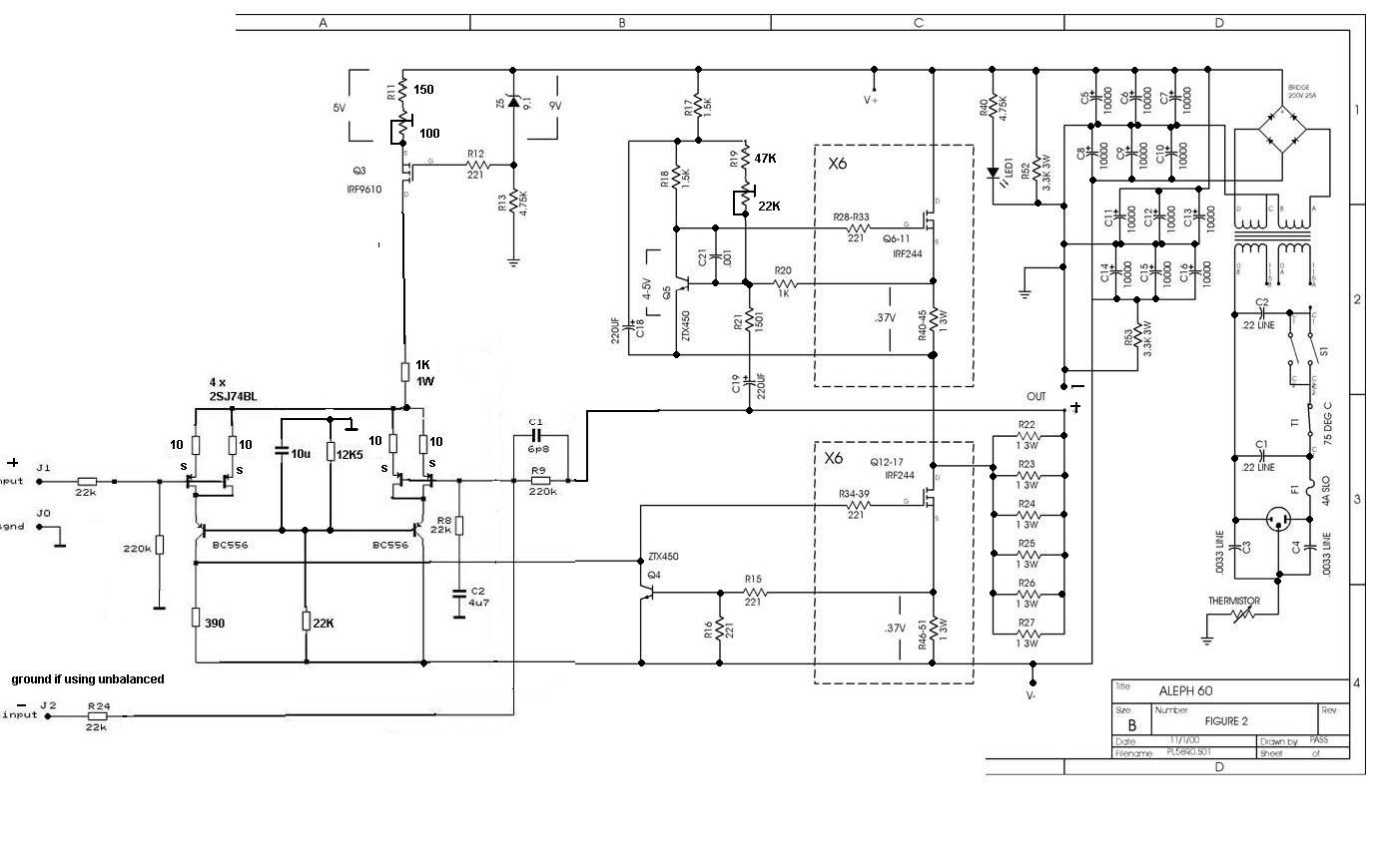

My starting point being that I'm in possesion of two large toroids, each giving out 650 VA and +/- 34 V to the rails, I found that the Aleph 60 would suit both the specs of those and my need of amplification - but I would like to have a Jfet input. Has anybody successfully built that or cold somebody tell or show how it could be done? :scratch:

There has also been pretty detailed and well documented explorations on adding a Jfet inputstage to the A30 - which has an inputstage which is identical to the A60 if my memory serves me well. This could give you all you need - layed out and everything :)
However, as I also recall, the tricky thing about the Jfet A30 was that the supply voltage was very near to the max of what the small Jfets could handle - so building a A60 with a Jfet input stage might require a second, lover voltage supply for the front end - and if this is able to sving the output stage to full - that is up to the more qualified personel on this forum to comment.....

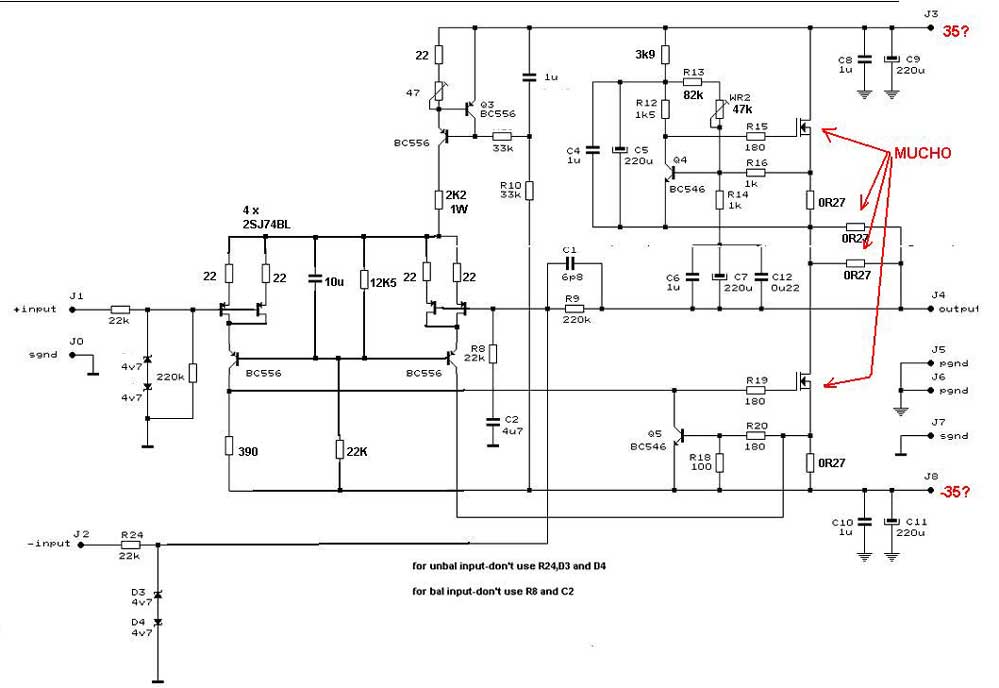

try like this
if you are not in mood for changing upper CCS , say and I'll sketch how to make original one adjustable
I presume that your 60 is made by standard schematic ?

I assume the bc's can be swapped for the ztx450 and 550 without any problems, so the job for now is chasing down some 2sj74's...
Ooops! Yes, I'm building using the schematic from the service manual.
I will do so. It might take some time before I'll be able to tell about my results, as I am just beginning to gather the parts - :blush: - but the 2sj74's should be on their way already!

As it can be seen from the dates of the postings in this little thread, it has been quite a struggle, but now it's working and the sound is amazing!:D
Maybe I'll write a little more about the amp and its sound in a later post, but for now I'll only wish everybody a happy new year and thank Papa Pass for giving people like me the possibility of owning a luxury version of the Volksamp 60 (I've named it The Volksamp PassAT). I would also like to thank Magura, Stenoe, and last, but absolutely not the least, Zen Mod for great patience and lots of help.:smash:
