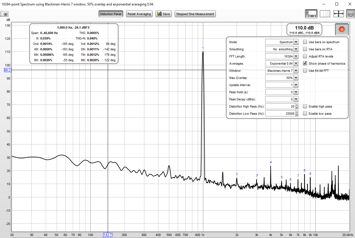

Ok, time to try again. Starting with the basic circuit that Nelson Pass provided in post #2 of this thread, and paying closer attention to the data sheet and my wiring, it's time for another day at the bench.
With the input voltage dialed down to 50mV, and using the test-mule Idss 7.3 device, the THD immediately dropped to 0.14%, and with tweaking, got it down as low as 0.12%, without feedback. I tried several different Id values (varying Rs and Rd), but Vds always ended up in the 3.5-4v range when tweaking for minimum distortion. Not what I expected - anyone have an idea?
Next task was to turn on the feedback to see if I can drive THD down. I have since figured out that I probably should have chosen a larger resistor for the feedback loop, as well as an even larger Rl, as both ended up maxed in several scenarios.
Initial turn-on of the feedback loop resulted in about a 24db gain loss, and THD was quickly tuned down to 0.0095 or so. I was trying to keep Vout at about 0.9Vpp (to match RCA-line-level voltage for the output), but this kept getting away from me. I probably would have managed slightly better THD numbers if I had kept an eye on the output voltage and gain...
Data for the run (harmonics are for H2, H3, H4 & H5) :
. harmonics -83/-88/-92/-97, THD 0.0095%
. gain 1.97/0.052, or 37.88x (31.5 dB)
. Id 0.45, Vds 4.6
. Rd 6.75k, Rl 5.35k, Rs 19.7, Rin 10 ohm, Rfb 23.3k
Remember that I have named the resistors Rd for Drain resistor, Rl for Load resistor, Rs for Source resistor, Rin for the input (gate) resistor and Rfb for the feedback resistor. Probably easy enough to figure out, but I thought I'd be careful with my nomenclature. Also note that Nelson's design does not have a feedback resistor in it. Mine goes from the outboard side of output cap (between cap and the 475 ohm output resistor) back to the gate.
I noticed that Vds was low in the earlier tests, so I cranked the voltage up to 40 volts, the THD went way up (to 0.025%) - so much for the sweet spot.
With some tweaking, I got the THD down to about 0.006x% with the x being in the lower digits. The output voltage is still a bit high, so I've probably given away some THD...
The data for this run:
. harmonics -90/-95/-90/-95, THD in the 0.006x% range (bouncing around in the lower digits)
. gain 1.12/0.035, or 32x (30.1dB)
. Id 4.5, Vds 4.3.
. Rd 7.91k, Rl 4.86k, Rs 19.7, Rin 10 ohm, Rfb 23.3k
Just for giggles, I plugged in some E24 resistor values and got the following results:
. harmonics are -82/-95/-90/-93, THD of 0.009x%
. gain 1.20/0.042, or 26.7x (28.5dB)
. Id 4.5, Vds 5.7
. Rd 7.50, Rl 4.71, Rs 20, Rg 10, Rfb 24.0
As "bad" as this THD looks (compared to the best numbers), I was able to get back into the high 0.006x range by simply running Rl up to max (about 10k), which also happens to be an E24 series value. So even with less "super" resistors I normally have in my parts bin, it looks like I can get quite nice results with stock resistors, I'll just need to try a few values out to make sure I've got the best numbers possible.

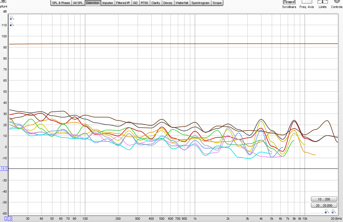

Odd note - I noticed my noise floor for my bread-board system was higher in the low frequencies and went down as frequencies went up. Any ideas? I presume it's all the point-to-point wiring, acting as antenna, but don't really know:
. noise floor at -100db above 1k, dropping to 110 by 10k, but -90 at 200hz, -80 by 20Hz
You can see this 'feature' in the first image below...
The first two images below are screen-caps from the test run using "standard resistors" from the E24 series (0.009% THD, tweaked with a different Rl to 0.006% THD) for a 40v power rail, the Idss 7.3 part and trying to keep Vout in the range for RCA devices. The 3rd is a re-post of original idea as presented by Nelson Pass in post #2 of this thread...
