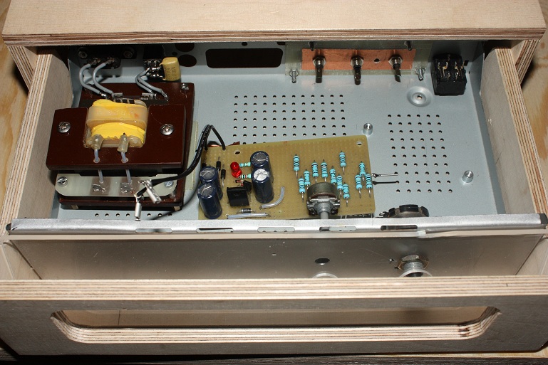

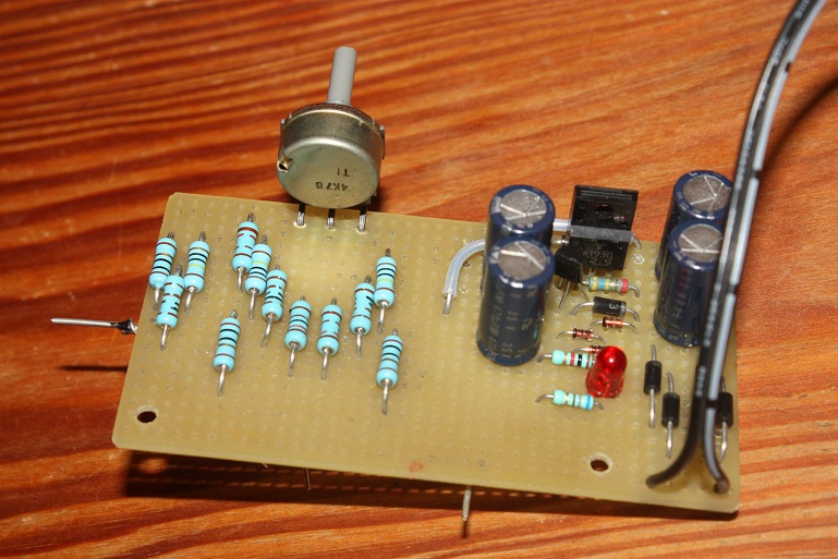

still working on it
jfets not mounted
actually there are 3 channels
one channel in, split into 2 channels
on board pot is just a channel balance
maybe it could have two functions, and also do tone control work
but I haven't figured that out yet
