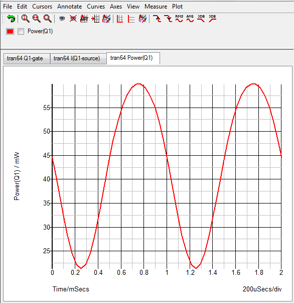

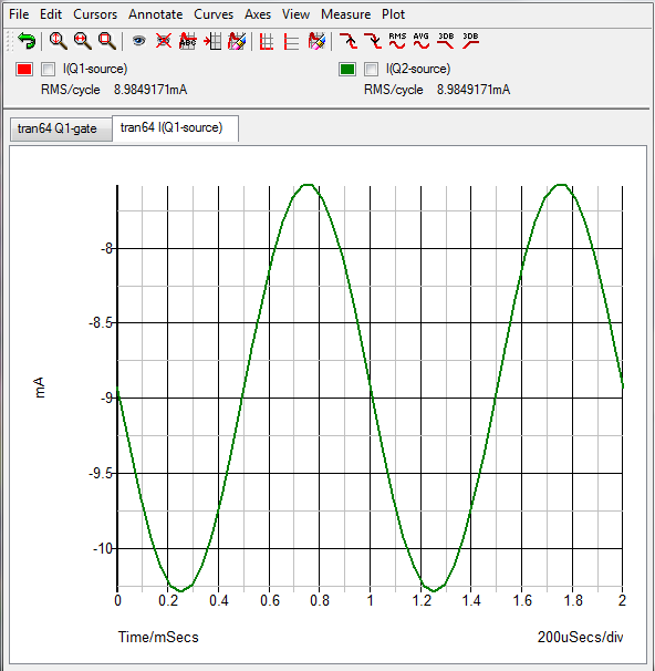

I played around with your ideas and came up with some valuable modifications:
(there's a very nice power curve and decent gain)
