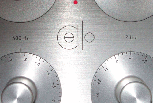

Last EQamikaze work out i did was a 3-band balanced 6dB up/down one with discrete JFET input opamps, loosely based on Cello's design and the tone control of the '83 Elektor Prelude.
I'd love to do a stretch limo version with minimum 4-layer (main) boards, preferably 8.
Just not worth a one-off, about as life sucking as constructing a Spyker in the back yard garage.
