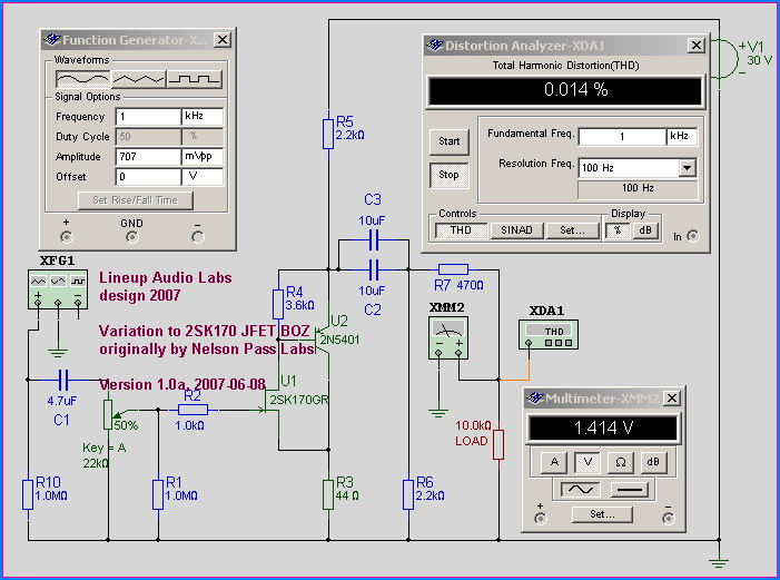

Re: Lineup Audio, 2SK170GR jfet-boz version 1.0
Do not forget this High Fidelity Hi-fi JFET Boz
that I contributed in the beginning of this topic.
That is, if you want one whole Level lower distortions.
Which is maybe NOT what all will like.
Not in this forum of Pass Labs
hehe, hehe, haha
Regards
Lineup
See Post #93
for additional setup instructions
to Jfet BOZ modificated version
lineup said:
People havent got anything else to do, than download Nelson Pass PDF.
Well, for myself speaking: I do not do much anything else
Comment to my attached SCHEMATIC
Lineup 2SK170GR Jfet BOZ - beta version 1.0a
Regards
Lineup Audio Labs, the design division
/lineup

Re: Re: Lineup Audio, 2SK170GR jfet-boz version 1.0
Hello Lineup,
What tools are you using for the simulation in this post #93 and #97?
Thank you,
-David
