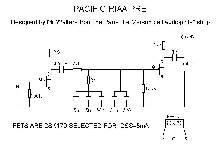

jacco vermeulen said:
Le Pacific is a JFET/BJT/Tube hybrid, google for bonavolta.ch
(Zenski is younger than me AND a relic, there's hope for me yet)
:whazzat: :whazzat: :devilr:
Oops again, me confuse with the Hiraga Pacific.
(btw, you'd like Mr. Walther)

Hmm... something else simple I may have to build up. It bears a passing resemblance to the JBOZ. I am about an hour and a half from home and will be for the next few days so I can't tinker at all:( Though I ordered some parts for the JBOZ and it's power supply that, with a little luck, will be on my door when I get home. It's coming along with some parts for a 300B monoblock build that is my long-running summer project. That is if I don't get side tracked with something like a Aleph-J or JFET buffered Zen V.4. Thanks a lot Master Pass, with this simple circuit you have gotten me hopelessly addicted to JFET's! I never knew a JFET in a simple circuit like the JBOZ could sound so amazing. I might have to give it a try but I have a feeling that a single BJT will not sound as good. Of course it could be that little bit of Zen magic that makes it's way into every Pass design, turning the ordinary into something very very special. At least my JFET addiction will be a little bit cheaper to feed compared to my tube addiction.
BTW I have a small stock of old 2N4220 JFET's that I might give a try in this amp, any thoughts. They are in little TO-72 cases with a fourth pin to ground the case. My dad used them in the industrial work that he did, they where for very sensitive low-level signal inputs. I guess I will just pop them in and fire them up, test it the old and fun way.

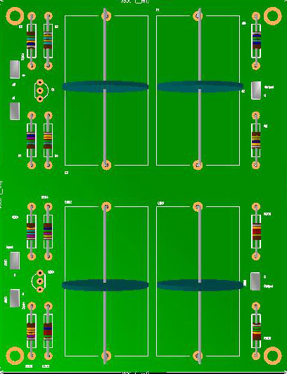

JBOZ PCB
Here is a simple layout for a double mono JBOZ, battery power of course. The circuit is based on Nelson’s schematic.
I started working on a Vero board but layout wasn’t to my liking so decided to do this one.
If any one interested on a 1:1 etching file just PM me
