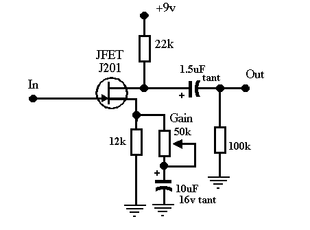

This is a very interesting thread. I make JFET preamps for low impedance bass guitar pickups I make using a similar design that was derived from a preamp made by Alembic. The circuit is about 25 years old.
I'm curious to try this JFET BOZ design using 18 volts, from 2 9V batteries.
Here's the circuit I've been using, except I use a MPF-102 and the output cap is 4.7uF.
It's variable gain, and I usually use it all the way up.

So, this got me thinking: I'm running a 15 volt supply, which--after the Drain resistor--leaves me with 7.5 volts. Does this mean that the Jfet only wants 8 volts DC, or so, on its Drain? This part of amplifier theory always confounds me.
Parts have "sweet spots" at which their distortion is at a minimum.
For this JFET with this amount of gain at this bias and with this
load, 8 Vds is the sweet spot for small signals.
