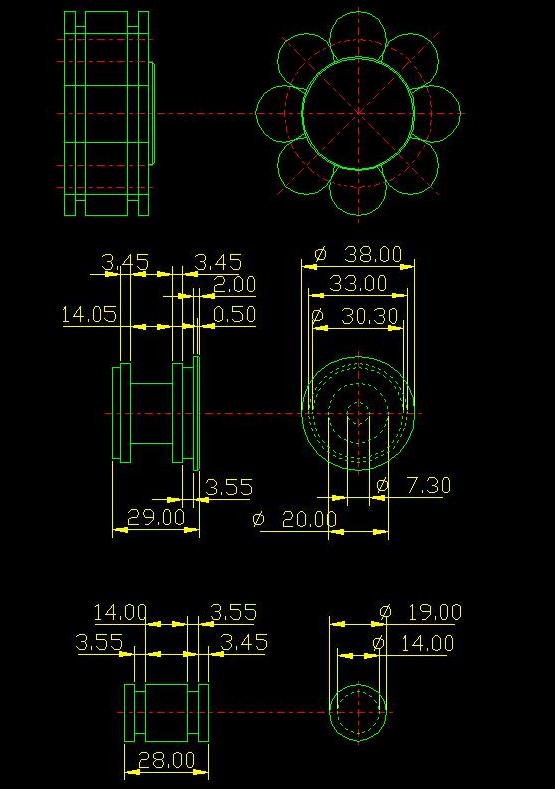

Nice piece of work Jerry and thanks for the cad drawing. Can you explain how it works?
It has eight smaller grooved rods sitting around a cental core that are held in place by rubber o-rings?
This sits on the TT pin.
Does the compression of the o-rings on the central core do anything other than hold the small rods in place?
Does it compress the "pin" hole in the central core for a tighter fit?
I think I can replicate in brass if I get those questions answered.

Thanks for the compliments.:angel:
The measurments on the drawing are in millimeters.
As the picture shows, the 8 outer rods are held in place by 2 O-rings 55mmX3.5mm (55mm is inner diameter). And that is all there is to it!
Make sure that the diameter 30.3mm of the core, and diameter 19mm are spot on for a perfect fit.
Most pins are about 7.1mm diameter so a hole of 7.3mm diameter is good enough.

Yes brass (non-ferrous) because I think I can turn the parts with the tools I have. I would lacquer it to prevent the tarnishing.

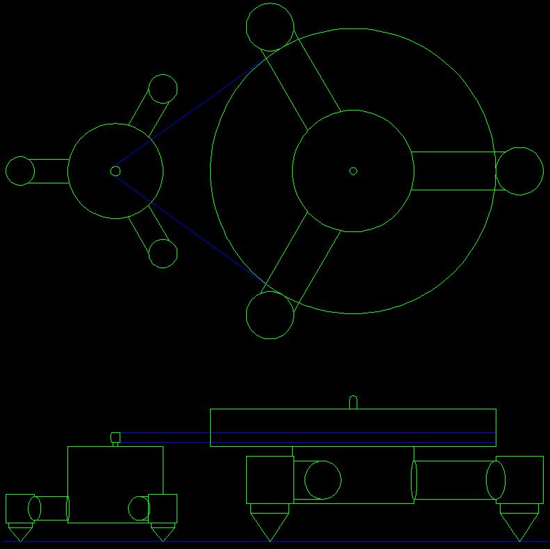

I think you'll find that every normal person does it like you do. Here's what i've got planned for the near future
Yes, i've got acces to C.N.C. lathes and milling machines.
Although this shouldn't be to difficult on a conventional lathe.
I made this drawing over a year ago, but didn't know much about a TT. So i started modifying my Thorens, to get a better understanding of how a TT works. All i have to do now is modify the tonearm on my Thorens, so i understand the basics of that too. Than i can start to build a proper TT.:smash:
