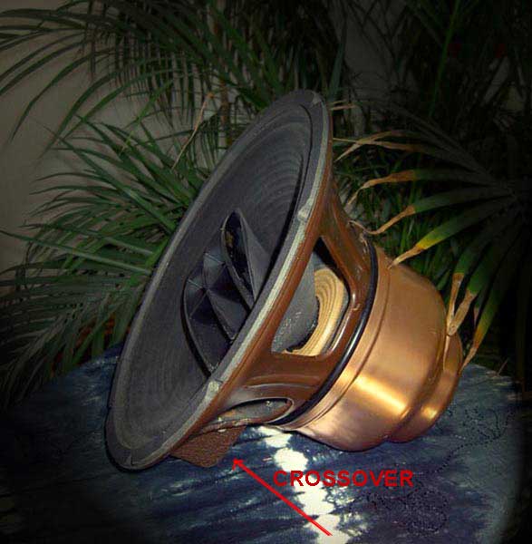

I don't remember any external "crossover" unit.
The crossover components are in the box on the side of the frame with the screw terminals on top. There was a 50 ohm pot on a wire coming out of it.
There seems to be room in the little box for only one resistor and a cap for a 6dB rolloff on the tweeter.
I think this is how it was. See if you can figure out how to remove that cover and see what is in there. Probably an old dried out electrolytic cap.
2kHz sounds about right for the standard H222. If the tweeter is 16-20 ohms, you would need a 4uf cap. 1 uf would yield something like an 8-10k cutoff!
Arguably, the tweeter could use a sharper rolloff, but with vintage gear it is often best to go with the original scheme. If you want to chase "ideal conditions" then DIY or get yourself a pair of modern B&C coaxes and work out a perfect xover!
By the same token, if you get too fancy with the crossover cap, say a Mundorf D), you might uncover problems you don't want to know about.
These speakers are worth messing with for the vintage speaker fan, I think. Smooth and colorful. The back horn cabinet had crazy bass, if a little uncontrolled. I used it on my TV to watch action movies for a few weeks.

Joao:
I found this pic of the H222 on your site. The crossover components are inside the box which the arrow points to.
Attached also another pic of complete H222s. There is a 50 ohm pot connected to the box, most likely a shunt resistor (10-100 ohm) and then a series cap.
Rereading your responses, I am not sure if you understood what I was saying about about the crossover. There is no external crossover. It is permanently connected and inside that box on the side of the driver.
Maybe you know this, but if not, it is important.
Once again thank you Joe for your input
I increased the cap and added a 1µF (the good old GEs), summing up to 3.7µF. It sounds much better now and it's a good starting point ... will listen now with this some days. But some measurements must be done as well to be on safe side and controlling
B&C, do they sound really so good and better the Jensens? Asked once the guys at Oswalds Mill but they have no info about the RCA coax. Anyway, it looks like it can be handled like the Jensens.
Yes Joe there was a misunderstanding because I thought they use an external cross-over and now I understand ... but unfortunately inside the box was only an 1µF which crossed the tweeter - too high as we know. The 50 ohm pot is missing as well.

jensen h222 in Onken Cabs
I made for them based on the Onken model. I did some checking - as these are 16 ohm speakers - and everything I can find says they crossover at 2K my calcs and the tables I have referenced have called for a 4.9687 uf (4.9) cap for the horn and (If I desire) a 1.27 mh inductor for the woofer which I may not do as it is not in keeping with the original. I was looking for the appropriate l-pad and so far 47-50 is what I am guessing. By the way these sound amazing.
[/IMG][/IMG]
I ran mine like mentionrd above... the bass-mid fullrange and cross only the tweeter with8dB filter. It's a bit higher like the 2k but remember the bass runs fullrange. Measures perfect with this settings, and sounds good of course.
BTW, I use this settings with my 15" coax drivers as well with good results.
