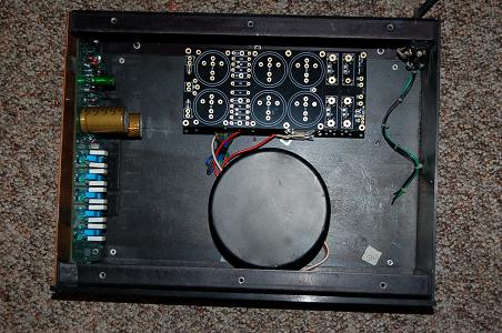

I'm laying out the chassis for my amps -decided to go with a pair of mono amps, using some old "junk" amp chassis I picked here and there.
As soon as the panels and heat sinks are drilled/tapped (and once I get some more power supply caps), I should be ready to assemble. :cool:
C'mon, guys- Let's see your images!
-Chas
