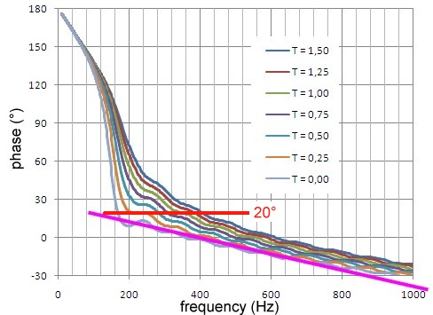

Hello Angelo,
I disagree, this horn possess an acoustical cut-off of 170Hz and as the group delay curve derived from pulse mesurement of many Le Cléac'h horns demonstrated that the group delay becomes negligeible above a frequency 2 times larger than the acoustical cut-off of the horn, we should use that horn above 340Hz.

Hello Limono,
Being myself very sensible to phase distortion I recommand everytime to use the horns in the frequency range inside which their acoustical impedance is the most resistive and inside which the group delay is negligeible.
I am not responsible of the way people use those horns out of my recommandations.
There was not honk when listening the large horn at Melaudia last sunday with Fc = 316Hz - 18dB/octave.

And which parameter values do you suggest as optimal?
It depends on what we want as a low frequency limit of use.
If we use a 18dB/octave T ranging from 0,7 to 0,8 give good results but we have to use a high-pass crossover frequency at Fc around 2 times the acoustical cut-off of the horn.
If we can use a very steep slope crossover then using T = 0 (this means a longer horn but the same mouth dimension) allows to use a cutoff frequency of the low-pass crossover very near of the acoustical cut-off of the horn. By example a 170Hz like the one listened at Mélaudia could be used with a steep slope crossover at 250Hz if we designed it with T = 0.

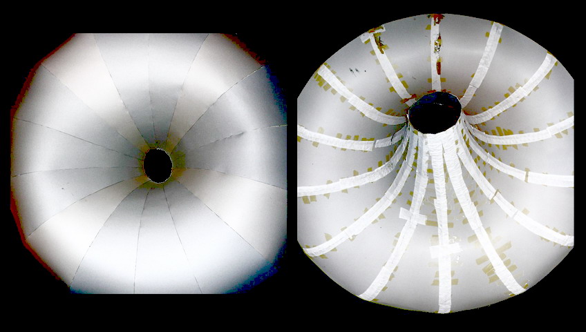

I made them using rather soft cardboard to get basic shape and than reinforcing it with fiberglass. Gluing cardboard edges gets you the shape so no need for fancy jigs etc. - simple. It turned out pretty nice and was quite easy. And with Altec 288 it sounds wonderful.
2way Altec/Le Cléac'h

vuki, nice work!
Pretty - nice copper color too!
After you did the cardboard layup, what did you do to thicken/stiffen the entire assembly other than a coating of epoxy resin?? Did you lay up multiple layers of cardboard?
How did you create the throat area & horn mounting??

vuki, nice work!

Hello Wuki,
Beautiful set-up, that gold color is very elegant!
You'll see in attached file another cardboard Le Cléac'h horn, "gramophone style" with 14 facets, calculated with my spreadsheet and built buy a French audiophile. (After the assembly the rear of the horn was rigidified using fiber glass + gelcoat).
Thank you!
The cardboard horns were reinforced by layers of fiberglass and polyester resin on the back side. Finish is "old gold" - schlag metal gold gilded with polyurethan (with a bit of brown stain) coating.
Throat area (square to round transition) is done with a bit of polyester putty and the driver mount is done with a plywood plate bonded to horn with fiberglass and resin.

When the frequency decreases toward the acoustical cut-off of the horn, the phase rotation accelerates and the group delay increases.
This has to be taken in account because a high pass crossover is generally used with a horn. If we do'nt take in account the phase behavior of the horn then the theorical target function for the crossover will not be reached.
Consider the acoustical phase curve of Le Cléac'h horns having the same cut-off (e.g. 160Hz) but different T values (see attached graph).
As you can see for a given "limit phase" of 20° the lowest usable frequency is 320Hz for a T = 0.8 Le Cléac'h horn and a bit lower than 200Hz fro T = 0.
I guess I could agree about the DCX2496 but in fact good results may be obtain with a DCX2496 if we feed its input with the correct level signal. Remember that the input of the DCX2496 clips with 10Volts RMS sine signals when most CD drivers delivers only 2Volts RMS max at their output. Using 4:1 transformers at the inputs lead to a better sound.
