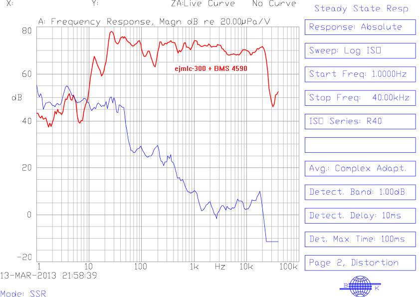

For those who wants play with ejmlc-300 and BMS 4590 here are the impulses 180 degrees with impedance (ARTA files, remove ".zip")

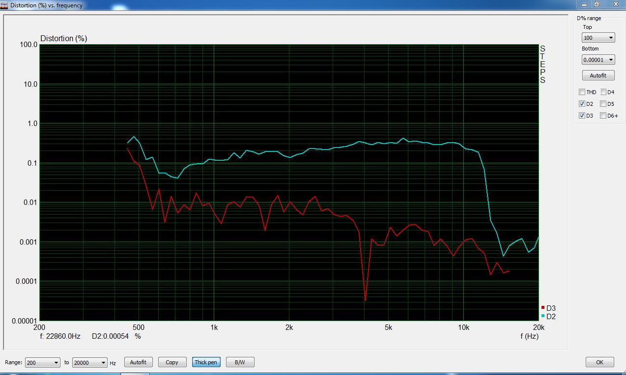

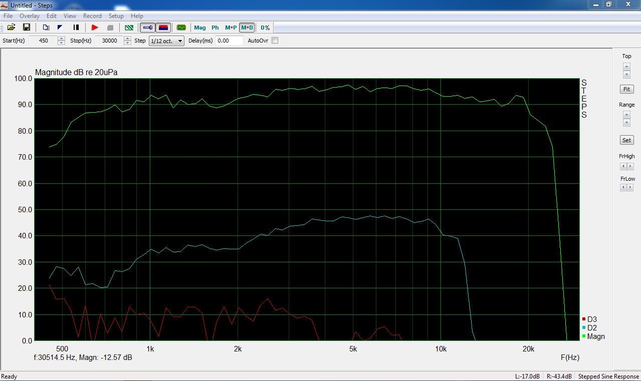

Thanks Eric,
Need to read up on Jean-Michel's crossover. A few questions.
1 - Is response D2 (in light blue) on your first attached plot, the TAD response?
2 - No protection cap on the TAD?
3 - Only a low pass on the TAD?
SMathews
D2 is the THD H2 of TAD and EJLMC 600 + SE 300 B LEGACY + Preamp diy at real 95 dbs SPL calibrated.
D3 is the THD H3 of the same;
And the green curve is the response at 95 dbs average of the same.
The second plot is the same think at the same level but the THD is in %. this level is exceptional and very low and with H2 dominante ( very good).
No protection cap on the tad.
Yes, just à crossover at 2300 hz ( with 18 dbs JLMC the cut off frequencies are shift.
Best regards.
Eric
Best regards.
Eric
Eric,
Interesting. I have no prior information to base the THD readings, but I trust your judgement. One point that I cannot understand is, how you implemented Jean-Michel's crossover for the EJMLC600, when you also mentioned you did not use a crossover directly for the TAD. The only conclusion here, is that you are using an active crossover. Is this active crossover off the shelf or diy? Thanks.
SMathews

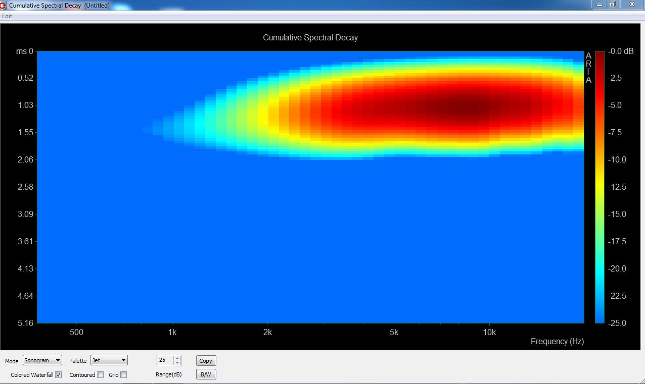

SMathews,
The delay in mm or in mms are very important for a best result.
IF your DEQX don't have correction of delay you must ajust the physique aligment of yours Hp's.
This step is very important for big sound.
The JLMC ( Jean-Michel) excel file give the good delay for hp's physique aligment = 0.
The "0" physique aligment is very hard to found and a ligment with ARTA impulse sweep with CSD calculation is the better issue.
Best regards.
Eric
