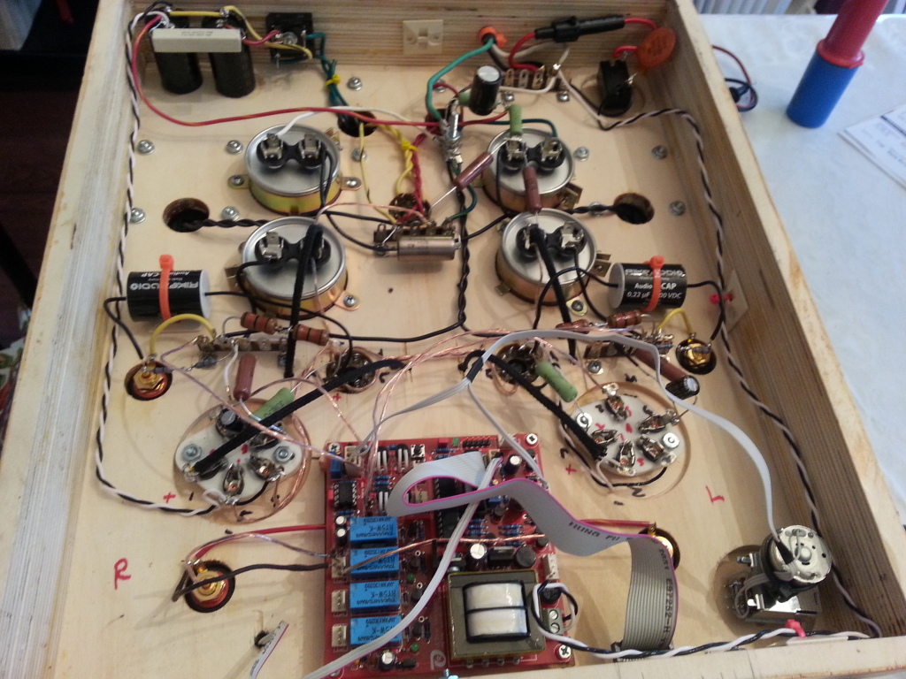

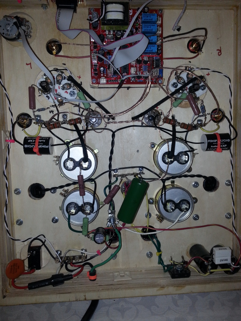

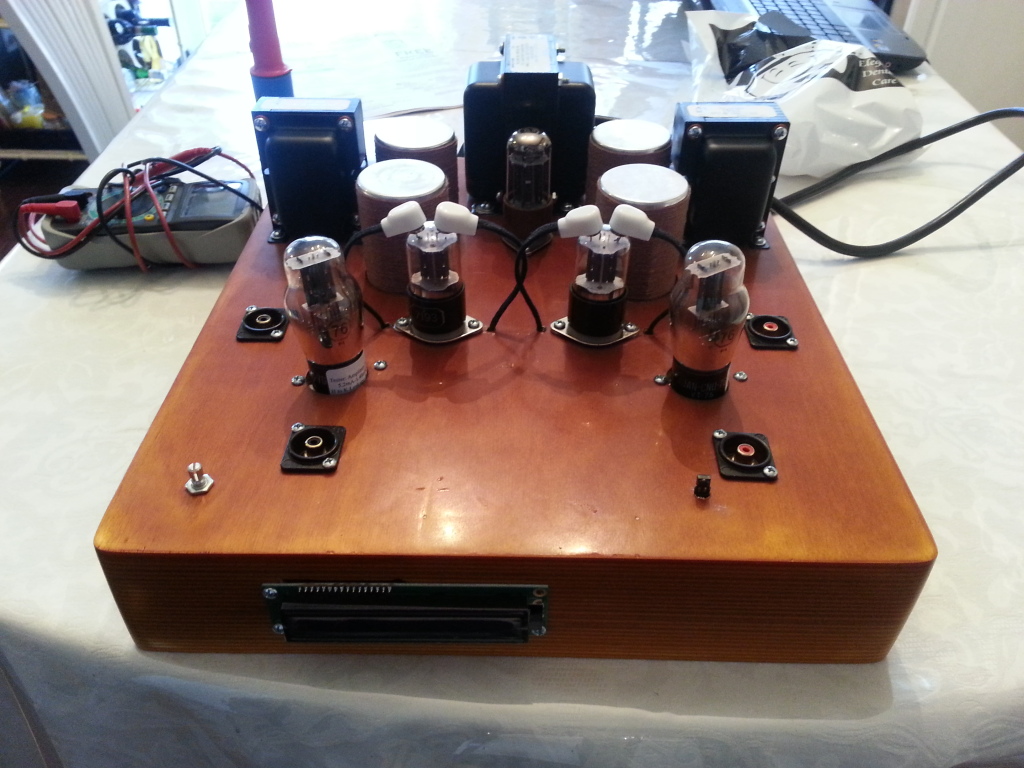

Hello All,
I just finished the preamp. It's dynamic and transparent. Will get a handle on how I will like it with more time,but so far I lIKE it. Thanks to all who helped, it is very much appreciated. May you all be blessed

Zgondouin, congratulations on your build. I too am enjoying the circuit.
