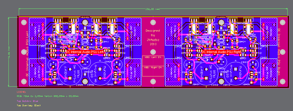

I read both threads and decide to build my preamp based on JC-80 schematic and discussed psu. Here are few schematics of my project:
  • AC Main PSU.pdf
  • DC Main Audio PSU.pdf
  • DC Internal Audio PSU Left.pdf
  • DC Internal Audio PSU Right.pdf
  • Dennesen JC-80 Amplifier Module.pdf
Hi pinnocchio
Mainly I based on your listening test about sigma22 vs. Borbely, so I decide to build the sigma22. But it will be pcb dedicated to my project (different/better components, different dimensions, custom-made heat-sinks). I will publish the pcb design after finish.
In Ist stage of my psu I used 3 el-caps as was mentioned in this thread: 2x full-wave bridges (connected together, not grounded), 1x el-cap connected to +/- rails (not grounded), common choke (how mH?), resistors in each rail, 2x el-caps in each rail connected to common ground. Next stages: sigma22 + cap multiplayer + JC-80.
I found 2SK216/2SJ79 on 2SK216 2SJ79 K216 J79 Transistors One Pair on sale - electronic parts and components supply store but I do not sure they are genuine Hitachi. maybe someone have any opinion about the seller?
Hi pinnocchio

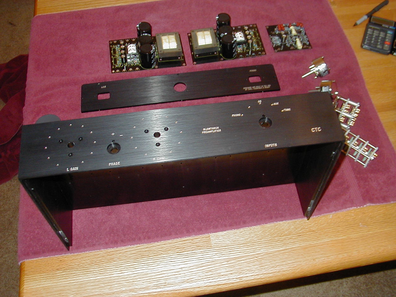

I want to use choke like John Curl mentioned in this thread and used in Blowtorch - see picture.
