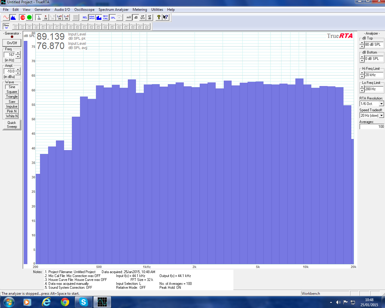

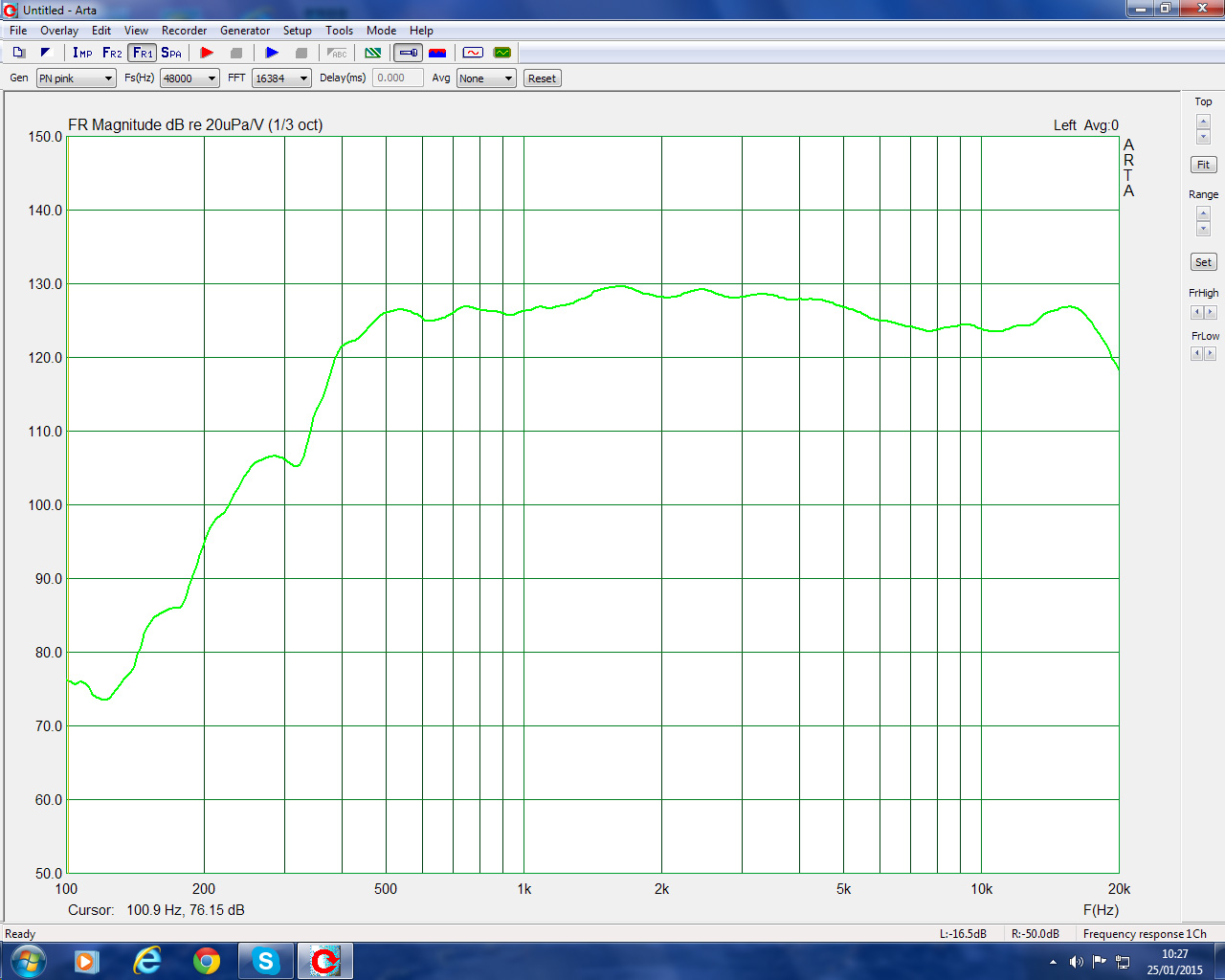

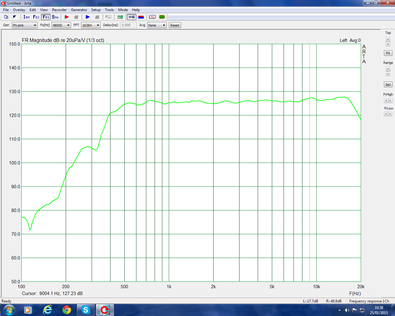

Now if you are active the story is very different. I am posting a few images here of what this horn is capable of. All are with the Beyma 750Ti driver. Only taken "in room", on axis and with ARTA and True RTA. Gated was taken but was so similar to the pink noise I haven't shown it here. Obviously it revealed more small peaks and troughs but in terms of trend the responses were very similar. I set a 24dB/Oct LR filter at 200Hz just for driver protection.
Clearly this horn/driver is not capable over 16Khz but at my age not so relevant! Anyway some will add a tweeter and I believe a good operating range for this combination is going to be around 800Hz to 8KhZ (Active....analogue or DSP!). It is just possible to see on the plots the small response anomaly at 800Hz which coincided with the resonance of this driver. I have designed a series notch filter just to notch out this impedance spike but in truth -6dB down at 800Hz with an active (DSP) LR crossover and the effects will probably be minimal.
An interesting alternative, particularly for those that like the simplicity of a "two unit" system (certainly advantages to be had) is to fit the BMS coaxial 2" compression driver. This has an Fs of 300Hz for the midrange diaphragm (well below the horn cut off) and the coaxial tweeter section extend to 35Khz. Although I am not a fan of using horns near their cut off, I would suggest this may provide superb performance down to 500/600Hz?
Anyway ..here they are for the Beyma 750Ti/2380A..first is uncorrected, second and third are ARTA and True RTA versions corrected with a final extra hf tweak applied to the True RTA version. Ignore the "levels" shown on the plots as this aspect is not calibrated.

Not sure what you mean...a "quack" would usually infer a response anomaly centred around 2/3khz. There is s peak here in the uncorrected plot which is easy to deal with. So do you mean a distorted sound...higher distortion due to the throat constriction/slot or does the response change at high spl?

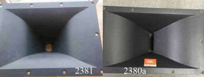

The lower distortion compared to older horns is due to a faster flare, and the 2380 already has a very fast flare.
http://www.jblpro.com/ProductAttachments/tn_v1n31.pdf
As can be seen page 8 the 2381 (1.5" version of the 2380) has less distortion than the square PT waveguide (which is deeper), and is said to have similar distortion to the rectangular PT waveguide.
