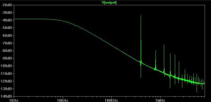

since its a class D amp, and that there is a low pass filter at the output, you might want to do some calculations before...
the bandwidth of this amp is already poor
let me check...
main filtering inductance is 220uh, 4.7uf and .33uf...what the...
forget it, i never saw the filter that much bad designed...i dont think it can hurt anything, the circuit can hurt itself anyway
the power output will be far less than before with a 8 ohm.
hth
Pat Allen
