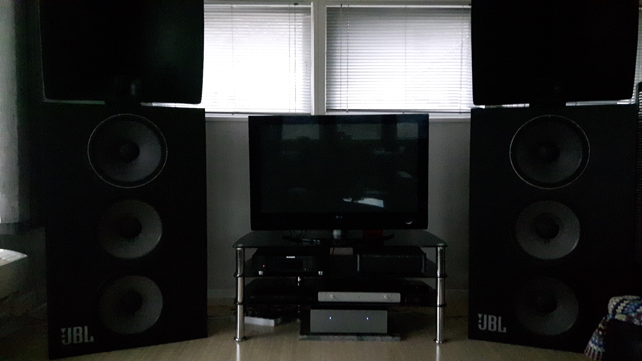

Hello Zmyrna!
Have tought about backfiring tweeter, have 2402 and 2405, but not got that far yet.
Will maybe bring some more air into the treble....
OB and horn I think go well together as both bring directivity.
Less reflection from sidewalls etc.
Have some reflection issue from left speaker as it stands close to side wall.
Should be positioned about 1m from sidewall.
But can`t put elsewhere so must live with it.

"OB and horn I think go well together as both bring directivity.
Less reflection from sidewalls etc."
"Have some reflection issue from left speaker as it stands close to side wall."
Try some sound absorption on the sidewalls to your preference maybe. Might help
Very nice project, I would still use the mini DSP for bass eq and delay. Cats know what is good for them.

Thnx both of you
Zen:
I`m not a designer. but I try
I learned from nice guy in Norway about using Golden Ratio when designing speakers.
The number you want to know is 1.6
Golden ratio - Wikipedia
So when putting together the front baffle, it is 80cm wide and 130 high.
80 x 1,6 = 128
so almost golden ratio.
Use this when designing loudspeakers and it will look kind of nicer
jacq:
It is no problem using DSP on this.
Bass must be delayed, also tweeter must be delayed.
but...I didn´t want to go there this time...yet
I´m not an anti DSP guy if you think so.
DSP is a very nice tool to get some things better.
You mention EQ, you think to get it a bit more correct/flet frq. responce or to get lower bass?

Oh! Reflection!
This is in our living room, cant put absorption on the window to the left.
right wall si ok, to far away.
Having OB woofers against the side wall is no problem, it supports the bass
Thats nice!
If I had space for it could have put the 2220 in midbass horn.
