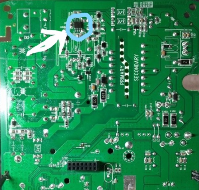

Hi, I was opening up my JBL LSR 305 for the ferrite mod when I saw this on one of my LSR 305. One of the 1315A don't seem to be sealed properly it seems; it was the only 1315A of all 4 (2 per speaker) to have this pop up symptom
May I know what is it called and what should I replace it with?
It's an inductor (or coil) with a ferrite core. Most likely part of the low pass filter between the STA350BW class D amplifier chip out and the loudspeaker connector. If so, its value should be about 15 µH. Not any inductor will do, because core size, core material etc. are critical. You might be able to repair the existing one.
Thank you, based on what you mentioned, the closest I saw so far is this:
Through Hole Shielded Inductors - RCS1315B SERIES - Manufacturer Coilmaster ELectronics but I am not confident if this is an exact replacement since I am not used to finding replacement inductors unlike capacitors. The usual electronics e-shops are not showing any inductor with the model name 1315A
I have also taken additional pictures of the mainboard for clarity; the parts numbers are L205 and L206
https://i.imgur.com/pgiDU9M.jpg
https://i.imgur.com/OorwjsY.jpg
Seeing all of these, I agree that I should try repairing the inductor (and do the capacitor mods too along the way). How should I repair the inductor and verify that the inductor is working normally via using a multimeter?
If it looks OK (most of the wire within or around the core material like it should be), the dc resistance is < 1 ohms, there is no obvious short circuit and the loudspeaker works, it probably is OK.

Quick update: I have successfully repaired the inductor and will post the pictures later. Unfortunately I am unable to test this yet as my amp went down
