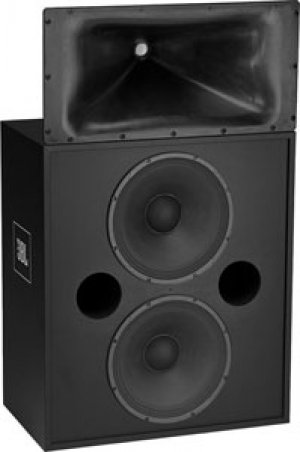

I have a pair of 2418h drivers and bi-radial horns I'd like to use in a two way design. I don't need to get high sound pressure levels from them... home not pro use. How low can I go with a crossover point? Opinions? Experiences?
Thanks,
bassnkeys in MN
You have the JBL 2374 HF horn for a crossover frequency of 1300Hz with the
JBL 3722/3722N Two-Way ScreenArray Cinema Loudspeaker System.
http://www.jblpro.com/catalog/support/getfile.aspx?doctype=3&docid=620
JBL 3722-HF | Performance Audio
Audio Profesional Bocinas
http://www.jblpro.com/pub/cinema/3622N.pdf
