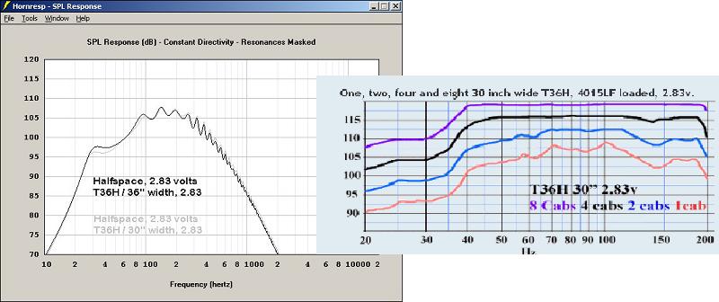

The published response charts don't match real world results found by others.Whats wrong with the tuba 36?

Typically tuba / titans are -13db at 40hz vs 100hz, where the TH is reasonably flat. This was huge for me, because I needed not just outdoors, but outdoors in the air (30' high) so I was running subs in full space. I understand Bill's philosophy on 'stepped response' aka, you don't need to be flat to 40. In my case, I felt I needed it, and the charts at the time led me to believe I could get what I needed from T36.

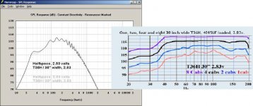

Here's a pic of the T36 chart in question. Just so everyone knows... this is clipped directly from BF's site at the time, and the hornresp was from bgavin, who has direct knowledge of the T36 IP... so this is not a reverse engineer from me or anything. I just want to make sure it's understood, I'm not the originator of either of these charts....

Hornresp inputs? ask BF or bruce.. and you won't get an answer. That's Bill's IP.
If you have the plans, reverse engineer as close as you can with the dimensions for whatever width you choose.
I cannot post any hornresp that I have done this with, without violating Bill's IP. (which I respect)
