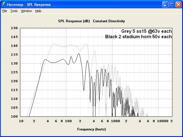

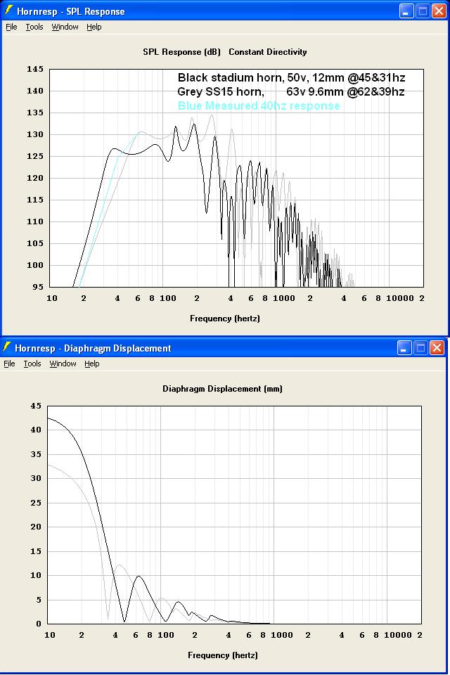

Thanks for the horn resp oliver, however I think to make a real comparison, excursion plots need to be added.
The stadium horn I will only run up to 50v, and the ss15 I feel comfortable running up to 63v.
Of course size must also be considered, and the big box is 2.5 times as big as the ss15, and right at 3 times the weight.
Big box for install, or for those really low notes... ss15 for everything else in my book. (I also attached a packspace comparison 5 ss15 vs a pair of stadiumhorn for those who are space restricted....)

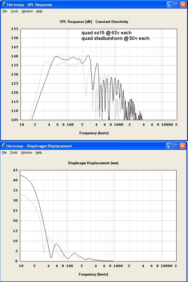

Do you have a chart for 4 stadiums vs 5 ss15. Just curious.
Shawn:
5 is kinda an odd number, I only picked that as a pack space vs pack space comparison. Where the stadiumhorn is 2.5 times as big -- 2 vs 5 was the obvious choice for the comparison.
Here's a quad ss15 vs a quad stadiumhorn.
They both fulfill their need, the get loud in quads... The stadiumhorn just gets louder lower.
Remember I measured 114db@40hz sine wave @20v per cabinet @ 10meters with a quad of stadium horns. That's some serious Woof.
Hornresp is not predicting that much... so I believe the directivity of a quad of stadium horns is at play in that measurement

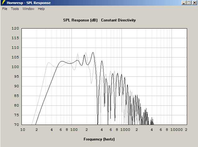

Jim,
The sim in #422 shows 40 Hz at 102 dB for a single stadium horn.
Four stadium horns should be 114 dB (+6 dB increased sensitivity for quadrupling cone area, +6 for quadrupling power), exactly what you measured, no directivity required.
At 1000 hz, an increase of 10 dB sounds twice as loud.
An interesting perception shift occurs down low, at 20 Hz it only takes a 5 dB increase to sound twice as loud.
+12 at 30-40 Hz is hard to ignore, the lower the speaker goes, the “louder” it sounds.
Hornresp models TH as having a lower LF corner in multiples. Multiple FLH do have a decreasing LF corner in multiples, like BR cabinets, tapped horns do not, as Tom Danley has stated and explained in multiple posts. Plots of multiple TH-15, in one, two , and four actual measurements show hardly any change in the LF corner.
I am grateful for such a powerful freeware program as Hornresp, the LF corner detail is no consequence for the usual DYI build using one or two units indoors, where rooms make nonsense of actual speaker response.
However, it is an important consideration for those of us accustomed to the FLH low corner going down in multiples, it does not happen with TH, even though the +6 or 12 dB from doubling and quadrupling cabinets frequently leads to the mistaken impression it does.
If you review your actual measurements you will probably very little LF corner change in four SS15 or Stadium horns, other than that which would result from the driver’s Fs dropping by a couple Hz going from a single to four, this same effect happens with BR cabs.
As an example EVX-150 single, 35 FS, two in close proximity, 34 Hz, four 32.5Hz Fs.
QTS goes from .251 to .27.
Art
