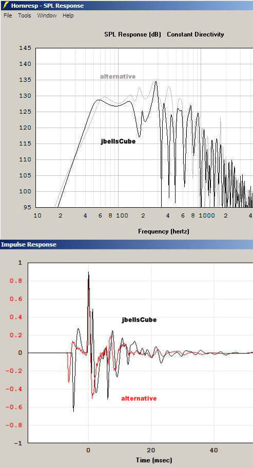

Hi jbell,
As food for thought I plotted Hornresp SPL and Impulse Response comparison for both boxes. I just don't like that big hole between 160 and 250Hz :) .

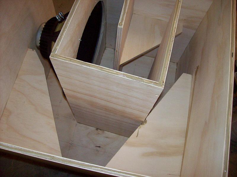

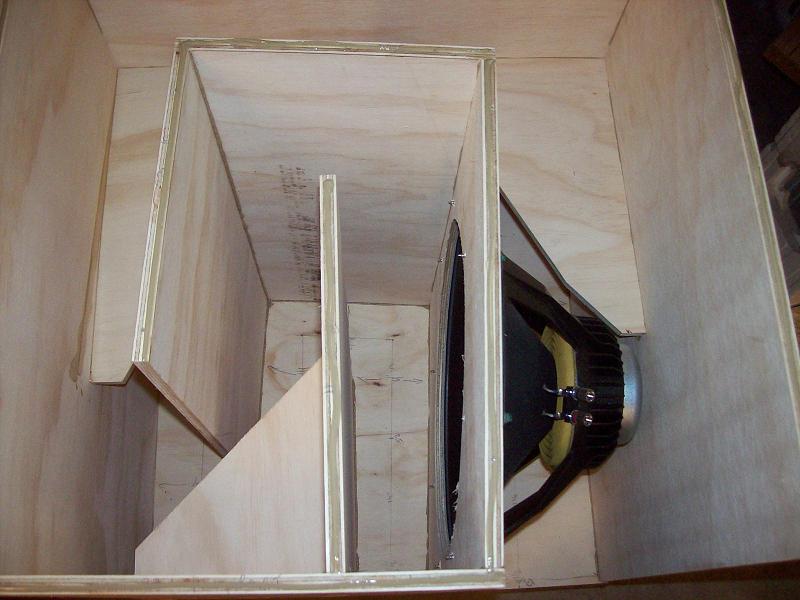

Here's some pics with some braces just put in. Have to wait till the glue dries before I know if they affect the sound any or not. I decided against reflectors, and to leave the 40hz alone.
Those angles are so close to square, I wonder if it's possible get away with implementing it as a stepped tapped-horn instead, with little loss in the passband?
I'm sure Brian's right, at least for under 100 Hz. My drawing is an exact implimentation of the HornResp simulation, but small "errors" in building
would not be significant. In fact, they might result in improvement.

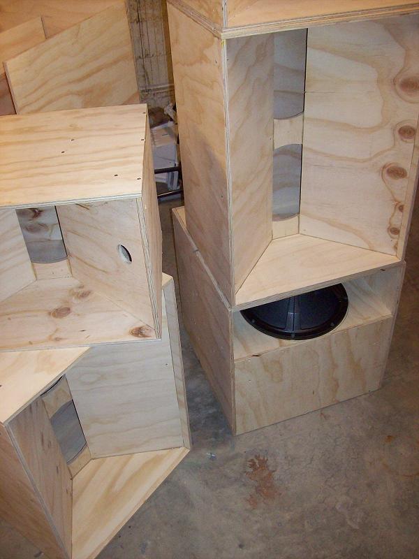

Working on some tops to go with these... I kinda think a pair of cubes would be a nice base (at least looks wise) for a dual driver top, 30degree toe in on each side of a wide stage -- no stands needed. We'll see.
