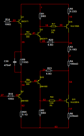

Hi ATAUDIO,
In the past i have done several compound outputstages (CFP) and i have ended up with the attached schematic.
Idling current is more stable because of R3 and R4, the thermal stability is increased but you will lose some headroom.
To minimise crossconduction set the value of R1 and R2 to a value as low as 49 Ohms. I choose 68 Ohm.
best regards,
Piersma

Intersting...
How you choose R20 and R23?
Did you want to have some voltage gain or are them there only to reinforce degeneration on driver side?
All the rest is pretty standard.
Thanks a lot

Hi AT,
I choose for a solid reinforcement for degeneration on driver side. (R20/R23)
Audiolab has done a commercial amplifier with a CFP output in the past.
(but there are several others too)
regards,
Piersma
