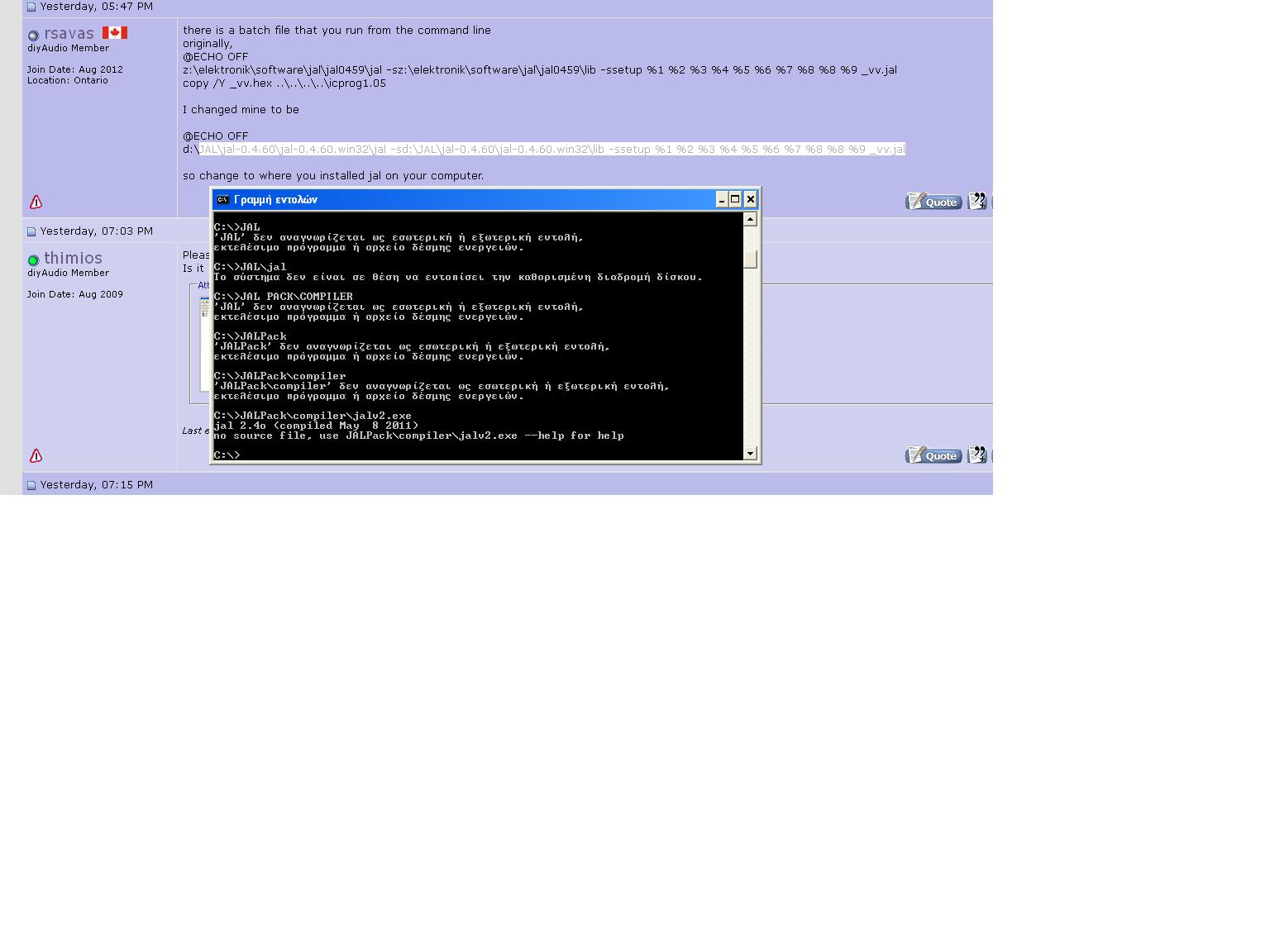

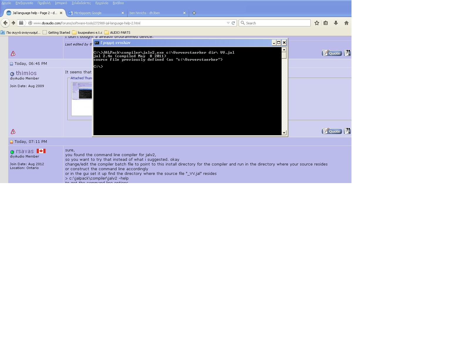

I followed these steps. Firstly, in downloaded version, in readme file, they say installation instructions are in INSTALL file. No such a file exists at all...
Must google a bit.
Actually I think I did it.
Stupid windows user :smash: firing up CMD once a year :D
Thank you Thimios and rsavas!
