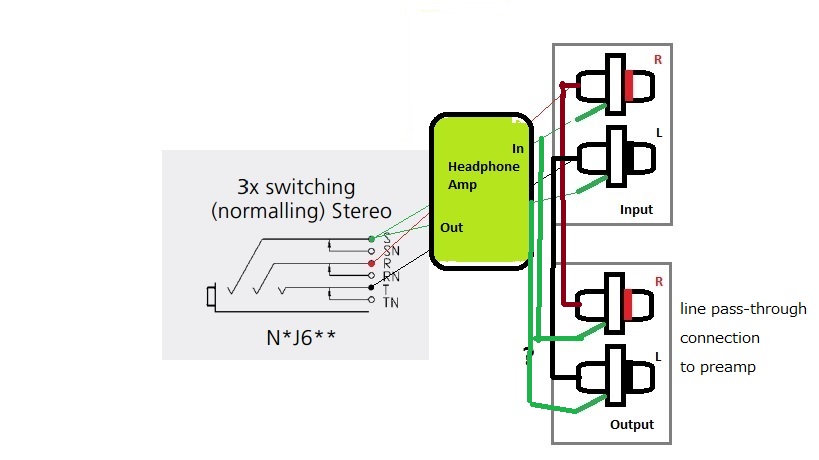

3. For the preamp connection, it depends what signal you want to feed to the preamp but I will assume it is the straight pass-through connection from the RCA inputs of the JMO2. In that case you cannot make it switch as you connect the headphones, at least not with the usual switched headphone jack as these can only switch the routing of the headphone amp output between the headphones and another output.

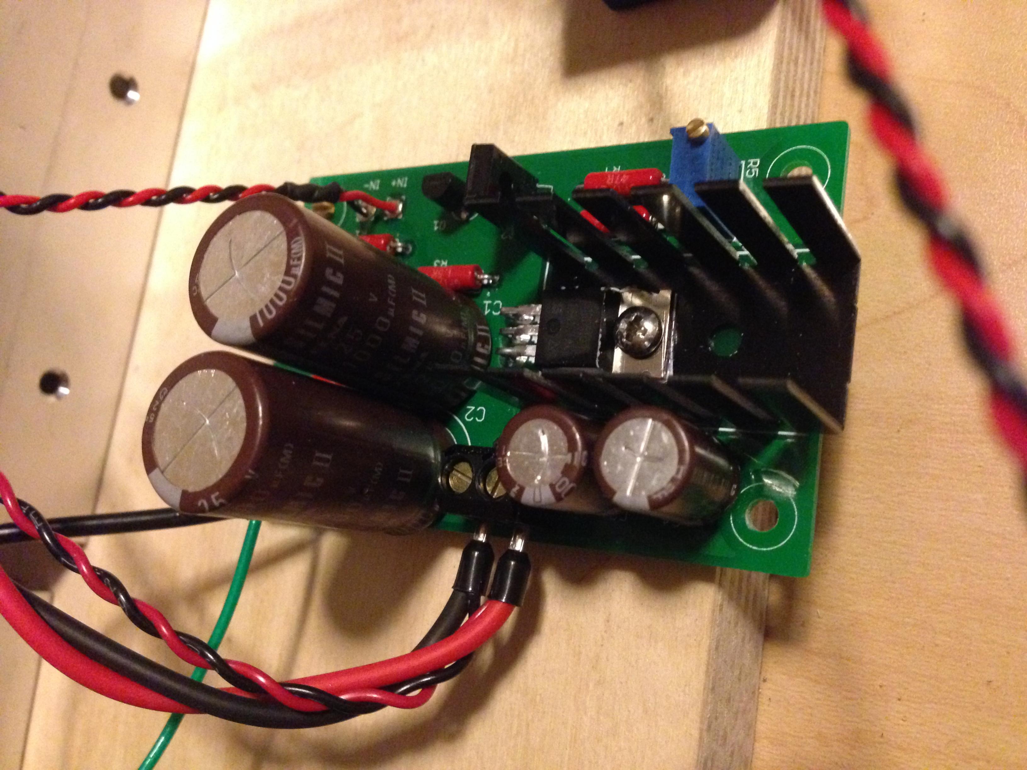

I'm just trying to advice to some hobbyists who might be interested to use this "best in today's market" caps. I used 10mm diameter Elna Silmic II RFS 100uFs 35V. The challenge was to bent legs of these caps since they have 5 mm leg spacing and PCB has 3.5 mm vias. Elna Silmic II RFS 1000uF 35V with 18mm dia used there too and PCB has 5 mm when caps 7.5 mm leg spacing. Honestly, I see no problem to drop such big caps there. There is enough space. Would be nice to have additional vias to support 5 and 7.5 mm legs. Please see attached close picture.
Thank you for RCA Output connection advice. I'll try it and in worse case, I'll add some toggle switch (on/off).

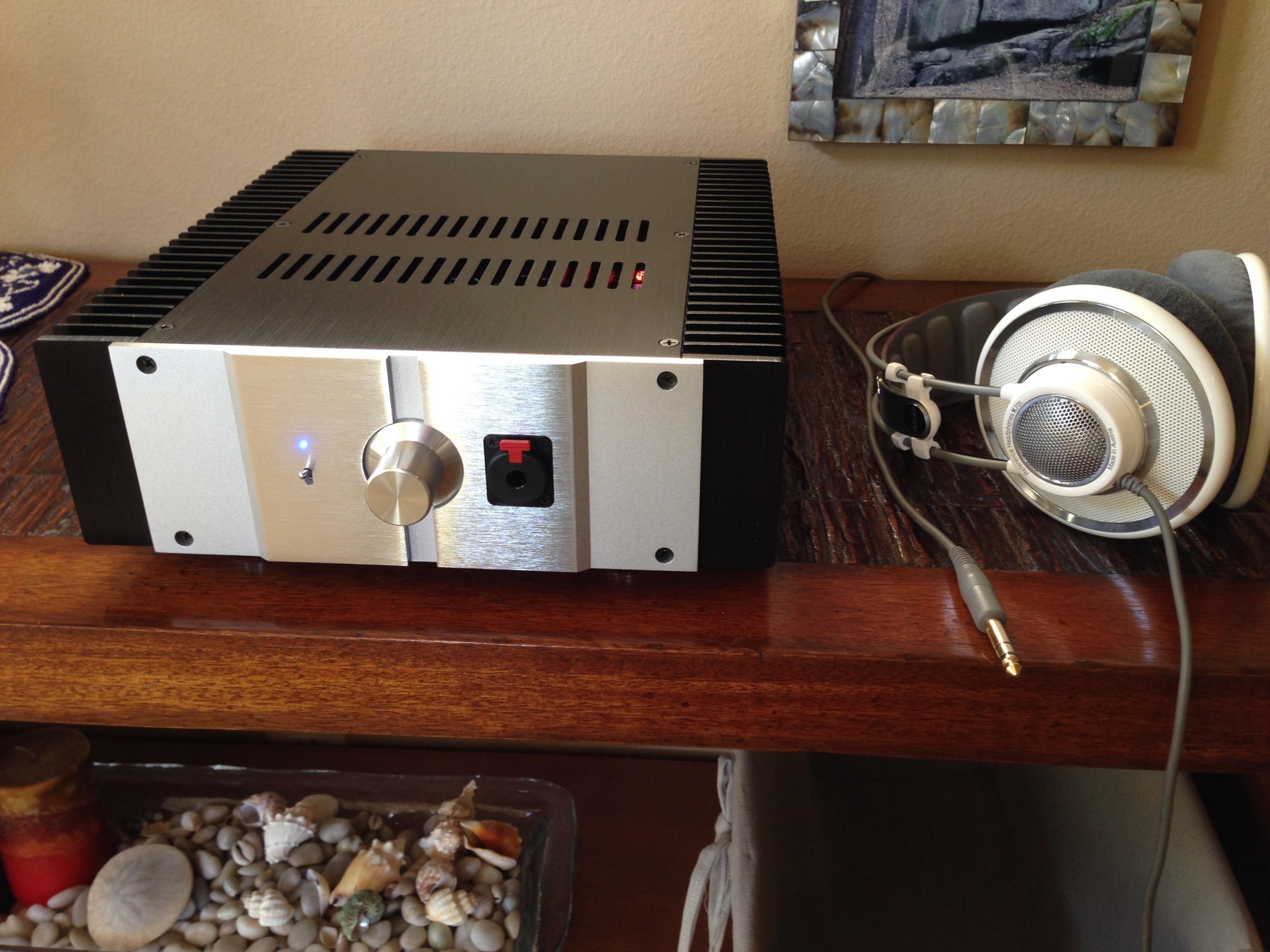

Hi Richard,

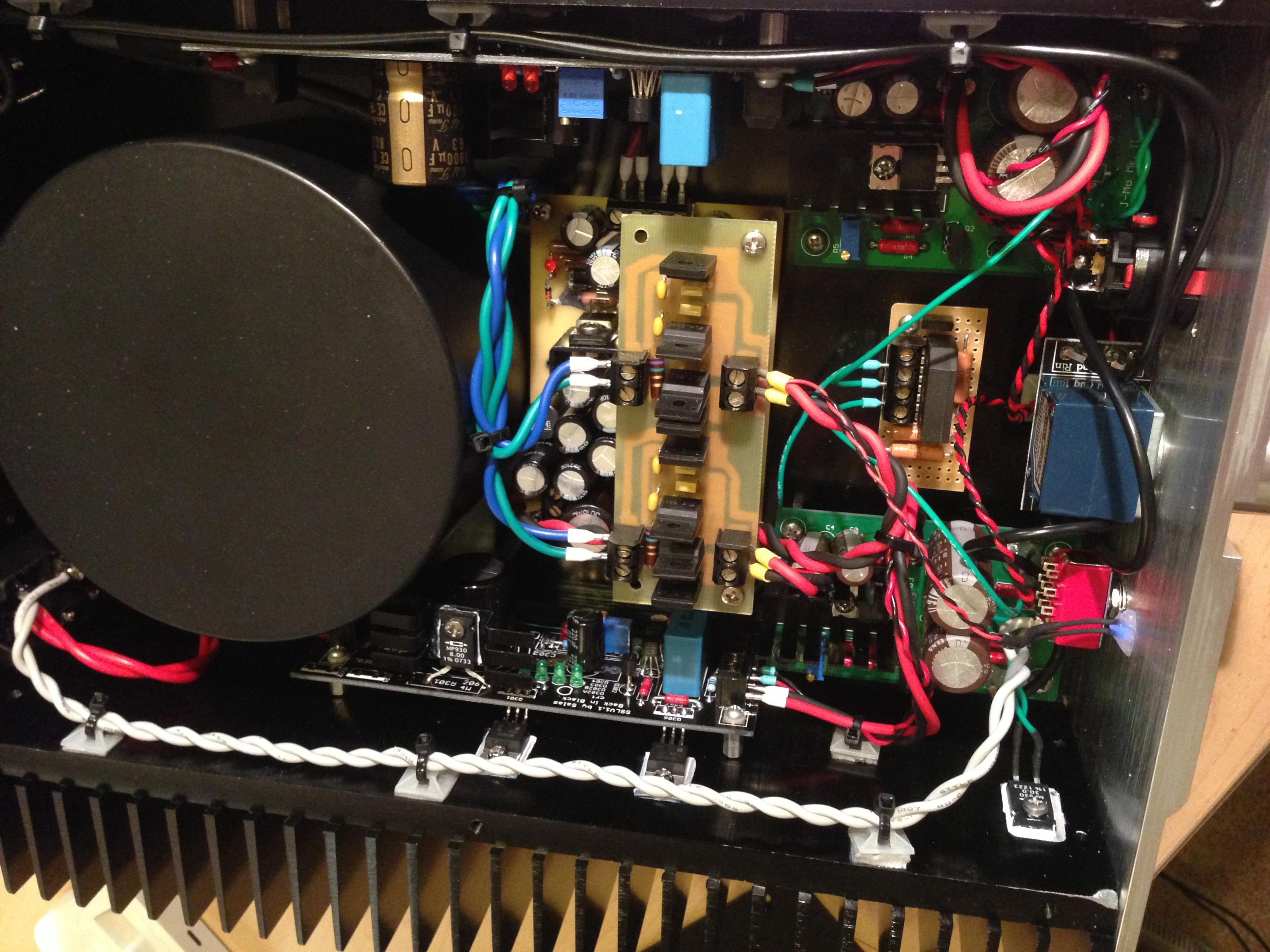

Finally, I finished my amp. Just received my front panel from local CNC machine shop...
It is an amazing project and I enjoined it very much and every step of it.
Please see my final setup pictures.
It is sounds amazing on both, my CD player and on my Turntable.
Thank you a lot.
BTW, I used Caddock MP930 resistor for R7 and also attached to the heat sink.
Also, my personal appreciation to all who help me to buid it:
Salas (BIB Voltage regulator)
Kentoken (K-Multi)
Billlouey (Raw DC and snubber calculations)
all others....
Thank you all.
