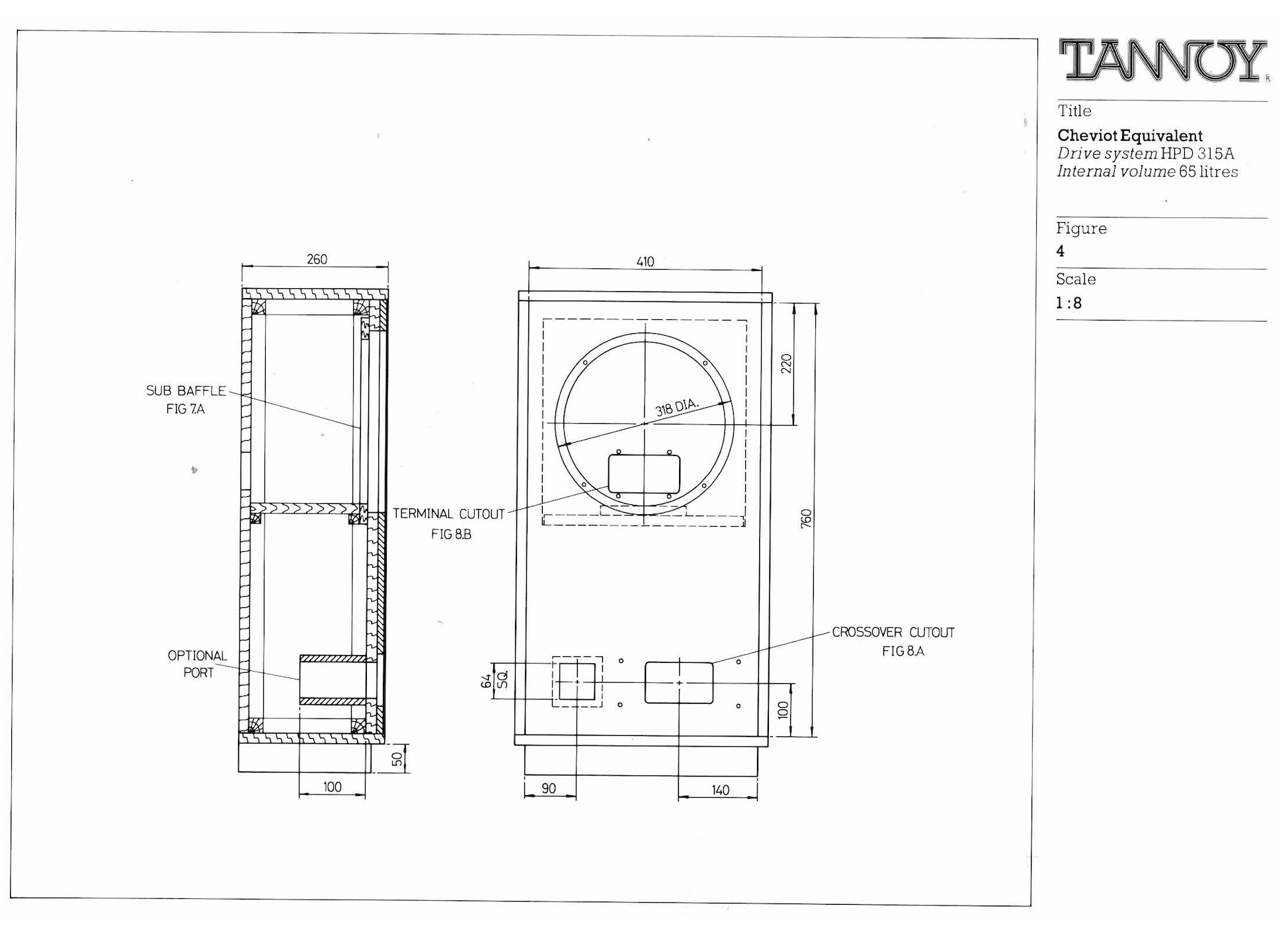

Hi all. I want to diy 12 inches floor speaker with Tannoy HPD 315 unit and iwistao IWISTAO 12 Inch Coaxial Enclosure Floor Empty Speaker Cabinet. But want to cut the holes in advance before shipment, unfortunately I don't have the unit on my hand at this moment. Have someone had measured the sizes before or had have its detailed specification about sizes? Need the sizes as attached photo (the photo download from internet, don't have it now), thank you for your help in advance!

Tannoy
https://www.hilberink.nl/codehans/tannoy100.htm
https://www.hilberink.nl/speaker.htm#tech
https://www.hilberink.nl/codehans/tannoy4.htm
pages 7&8 ?
Tannoy HPD series techinfo + cabinetinfo (zip format)
pages 7&8 ?
contact Tannoy or Monitor Gold site for information
