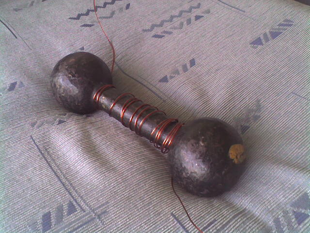

First attempt ! How does it look like? Is it good?
Hehehehehe just a joke ! :clown:
Apart of this, I really need help regarding this !!! ;)

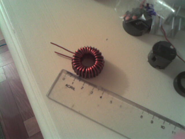

I couldn't wait for an answer, and I went to the store and bought some ferrite cores. They were VERY cheap. I just finishied winding it right now, and here is the picture of the inductor.
The wire is 18AWG, 28 turns, how much uH do you guys think that it have?
Thank you !
You must know material type and size to calculate the inductance.
If these are ferrite toroids (0.9 inches?) you get 1000uH (1mH) with material 68, that has low permeability (20) and about 35mH (35000uH) if material type is 43 (850 perm).....
I don't think this is the right material for the application.
Take T106 Iron Powder cores with low perm. The red type (perm 10) needs 59 turns of wire to get 47uH. If you use 20AWG the turns will fit in a single layer.

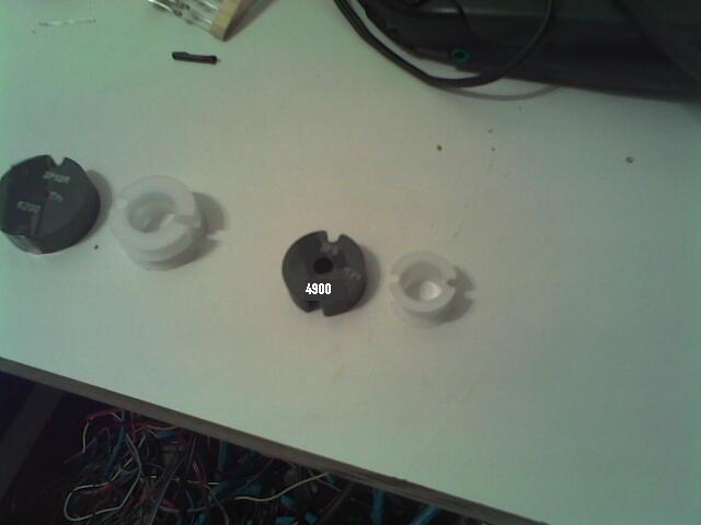

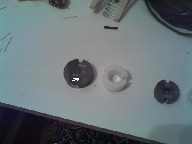

I also have two ferrite cores, one is type 62 and other is 49. The Type 62 is bigger, and have a hole diameter of 15mm and 5mm of lenght.
The type 49 have a hole diameter of 13mm and 10mm of lenght.
I'm not sure about the ferrite types, so I took a picture of it, as it was difficult to read I wrote using mspaint what is marked on it.
Take a look:

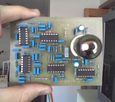

Made in home circuit, layout and board ! Take a look...
Good luck, but take a careful look at the SMD chips that are on the back of the board in the photo of my amp (see inset in the upper right corner). That's the decoupling that is required for the TDA8920. There are some fairly small feed-throughs (vias) that you are going to need. Not impossible with home techniques, but there are some good challenges here.
I vaguely remember someone describing some trouble they had with decoupling with this amp. Do a search on this forum for 8920--you might find something that will help.

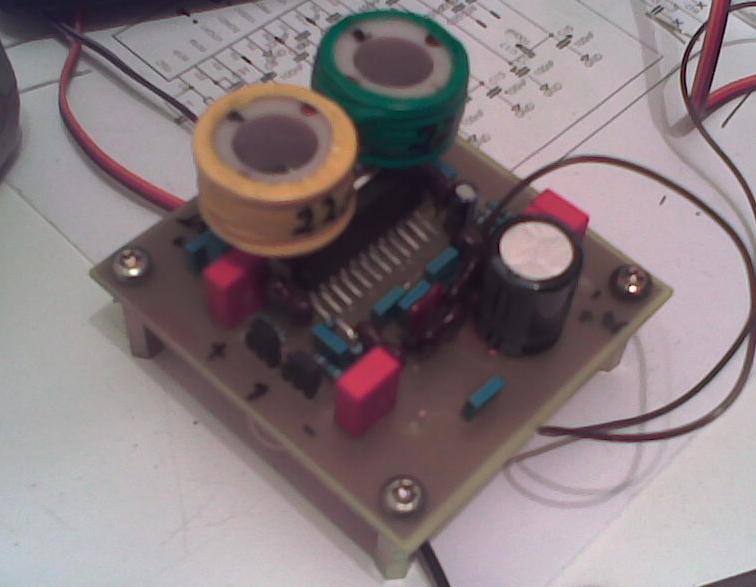

I've sucessfully built the amp !
It sounds GOOD, very pleasant sound, very accurate highs and good bass. The cone control seems to be also very good.
The inductors are Air Core, I've built them based on:
http://www.pronine.ca/multind.htm
I enjoy it very much, I have a very small dissipator, and it works fine with.
The inductors runs less than warm, is this fine?
No HUM or Hiss at all.
