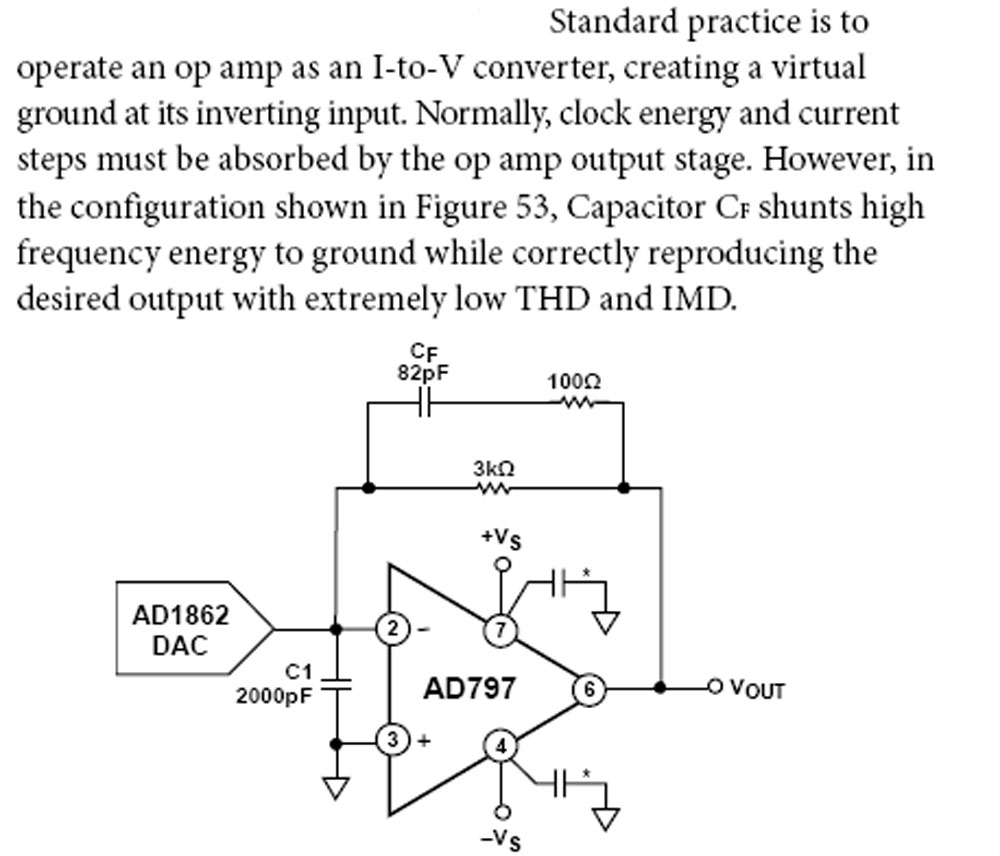

I tried this around 1991 or so, the DAC is probably out of date now. The two capacitors and the BW of the op-amp form a critically damped two pole system, I don't know about the Dutch circuit but the principle is similar. The results at the time were remarkably good. The picture is from 797 datasheet

Is this true? With the 1800 pF in parallel the gain has been lowered with 40 dB at 3.5 MHz. From 0 - 20 kHz the signal could be 8.8Vpp (with 0 dB on disk) indeed, but not at higher frequencies. Do I make a mistake?Joseph K said:Again, uhm, let's try to re-calculate the slew rate requisites for the OPA:
The maximum swing Ipp for the PCM63 is 4mA. That is converted by the 2.2Kohm in your converter to 8.8Vpp max. - on the OUTPUT.
That is, this is the step which should be re-created by the opamp on it's output..
With OS is mutch better (see above), right? I still have somewere a wrong exchange of ideas. The 4 mA jumps are in both cases 200 ns, so....... what is the difference for the slew rate?................help!Now this is extreme, but it's how it looks your 20KHz +19KHz test signal without OS!

With a PM3233 oscilloscope (10 MHz, 35 ns, 2 mV/cm) and a decent probe, I measured the output voltage over the pins 6 and 7 of the PCM63 (which is followed by my op amp IV with OPA314).
I could see LF-signals from a few hundred Hz up to 20 kHz. The higher the frequency the larger the signal,
BUT,
I could not find anything at 8 x fs which is about 3.5 MHz. NOTHING. Even without the 5 nF capacitor!
I think, I cannot trust my simulations. The IV is much better than expected from simulation.
I think I leave out the 5 nF either.

I did find the answer myself!
From my radio-experience I know that in a heterodyne receiver a small distance between local oscillator (LO) and the frequencies to be received (RF) gives a lot of spurious. In general: the larger the distance, the less spurious. However there are regions you should better not use (see my web site).
In this case the RF is the audio-band ( 10-20,000 Hz) and the LO is the sampling rate..........
In our case the 'mixer' is the IV-conv. This should be very linear so that the spurious are as small as possible of course, but oversampling is a must from this point of view.
(I never understood the non oversampling lovers.......)
PCM1704 iso PCM63
With a PCM1704 one will find less intermod distortion than with a PCM63 because the 1704 outputs 1.2 mA and the 63: 2.0 mA!
Perhaps folks think the 1704 is a better DAC than the 63 because 'thay sould better'.
It could very well be that their IV-conv can't handle the 2.0 mA from the 63!!!
