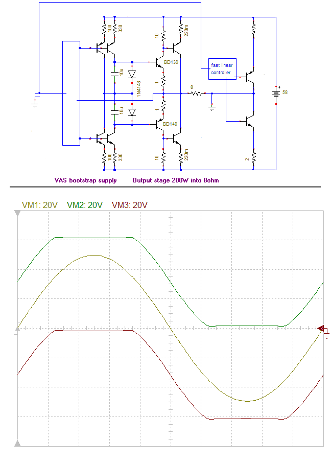

Here are two attachement.
First, only linear applied:
1. Half power required for classA operation.
2. Lower (half) components voltage rating. The current rating will be the same.
3. Simpler power supply.
4. Wider component choice because of 1. and 2.
Second is using switching assistant.

That looks like Class AH.
Ok.
1. Much more.

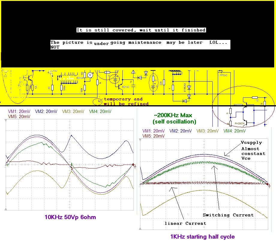

Nice one, show the full schematic at least
No, too complex for DIY, it has 100V opamp inside, (Hehe, beter not to show it) also the schematic is changed. May be it can be simple later, or may be not.

Sorry, the switching assistant is removed for some reasons.

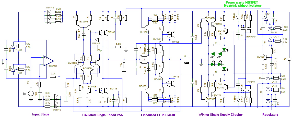

Seems that BJT power output stage cannot handle the rail ripple in low feedback mode. I am going to migrate it into MOSFET, there are two choices await:
1.Using my quasi, with crossing management, fastest and lowest distortion.
2.Using my simplest floating driver. Only need +/-12Volt floating supplies, low power consumption.
3.There are two choices, anyone if any third choice please suggest.

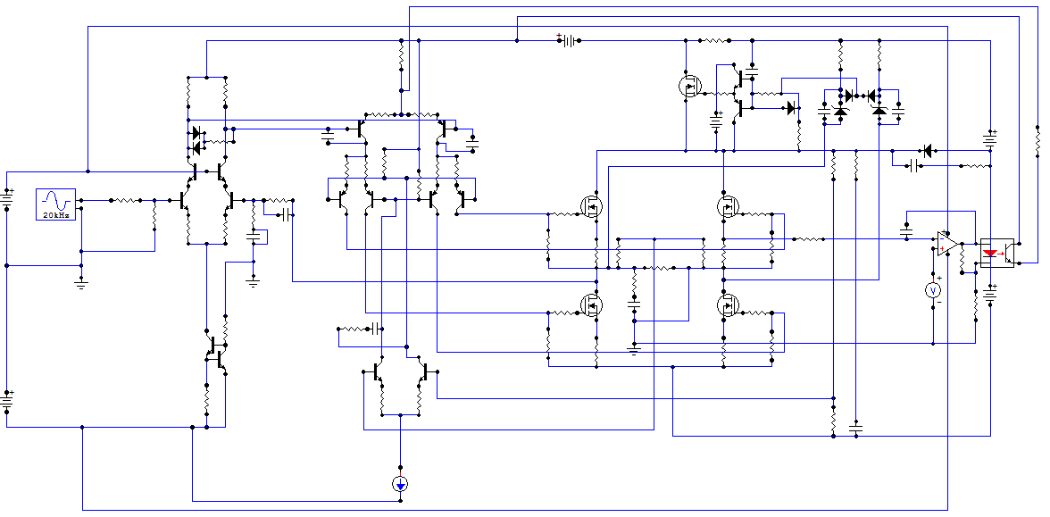

I wonder how well this would work in class G with an N-ch/P-ch pair and just a simple zener level shift?
Somewhat easy and linear envelope follower
Mackie's topology also added two more mosfets and advantage of using power waste transistor only one series with battery, and not pair at +and-. The only difficulty is to achieve 10KHz and up.
Well and easy for dual supply, with single supply switched, the mosfet capacitance will kick the rail when voltages fast rise and fall. The problem is low error correction output that used here, that the supply must be low ripple, or change it with high error corrected output.
May be it is better to use Mackie's single supply, Mackie win again .
"only one series with battery, "
I'm not sure of what you are getting at here, the Mackie has two mosfets in series with the battery, one for the + rail, and one for the - rail.
If Mackie had used an IRF9540 for the -rail switch (instead of an IRF540) they could have just used a TL082 instead of having to build a high voltage opamp with discrete parts.

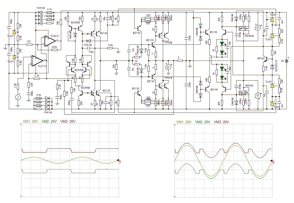

Yes, only one series with batteries to make its voltage variable. In this case Mackie using switching converter instead of dissipate power. Those mosfet at + and - rail only switch the voltage to ground and not to dissipate power.
I am now planning to mix both Mackie's with this.
It will start with 20V (regulated from 50V). With center reference it will smoothly track the output until it reach almost 20V (see post#23 only linear applied picture) then the voltage rises to track the output until 50V (in this case the output is almost 50V sine). Then it track down until 20V again.
The regulator here take major power dissipated, and regulator is only one series with battery, right??.
In normal class B amplifier with dual rail, the transistor that in inactive session is not dissipating power and just off.
With this next mixture, we don't have to dissipate power at output transistor, but in regulator. We may choosing high quality output stage for amplifier and cheapo transistor to dissipate power with no inactive session.

But i can see a class-A biased output section till +/-20V and class-AC till rest of the swing and step being in class-G linear envelope follower as best for high-end thing.
Yes like that. Class AB for +/-20V then track more until the rest (50V if the supply is 50). Any better solution?
