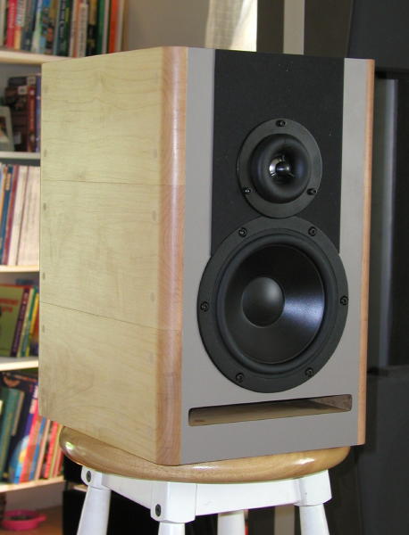

As I said in the other thread, those are the best sounding speakers I have at the moment. Much of it is probably due to a very simple crossover, consisting of just one series cap (Siemens MKV) with a tweeter. I might be also upgrading to Skan Speak 9700 drivers. Although the bass is not comparable to what I get with 15 and 12" in parallel in my main speakers, it sounds pretty fast and real and I like a lot.

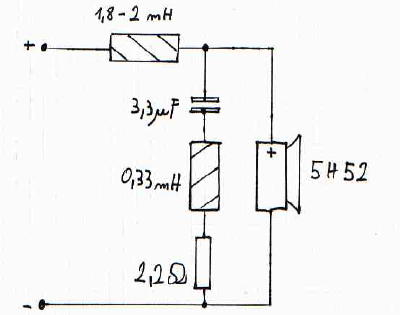

I am replying today because I am rather puzzled by the woofer frequency response graph and the schematic you posted. The two don't really go together, particularly that notch filter. I have always thought that center frequency of notch filters was easy to calculate.
In Excel use the following formula to determine center frequency of passive notch filters.
=(1/(2*PI()))*SQRT((1/(X*Y)))
replace X and Y with the cells containing the value of the capacitor and inductor. Capacitor values are in scientific notation for microFarads and inductor values are in scientific notation for milliHenries.
I apologize for the inelegance of the formula. I used to use one that looked much nicer, but with the last Microsoft upgrade it stopped working. Using Excel’s built in formula builder produced the above. I believe it works, what more can I say. I gave up long ago trying to figure out Microsoft upgrades and have learned to just go with the flow.
The values in the schematic yield a center frequency just below 5 kHz (4822.877Hz). The 2.2 ohm resistor degrading the quality of the series notch filter is quite small in comparison to the source resistance of the inductor about 2.5 to 3 octaves above its knee point. Even with the resistor this notch filter will have a fairly deep notch.
Now the puzzling part. In the frequency response supplied, there is nothing shown in the 5 kHz range that you would want to notch out.
Three possible hypotheses:
One, despite several decades of calculating filters and then verifying them experimentally, I have miscalculated the center frequency.
Two, the frequency response graph is not accurately showing the cone breakup response.
Three, the schematic supplied is irrational.
If hypothesis one is correct, then I have just wasted server space and bandwidth. If two is correct, then I am really happy that you are pleased with the sound of your speakers. If three is correct, then the driver manufacturer is seriously confused.
Again, thanks for sharing your project,
Mark

Hypothesis one is partly correct - you have miscalculated the centre frequency because the formula you are using doesn’t take into account the woofer impedance at the target frequency. All woofers have raising impedance at higher frequencies due to voice coil inductance. Applying a textbook formula in this situation leads to missing the target. I use simulation software in these cases.
Unfortunately I cannot point you to more sophisticated formula right now either but I am sure somebody here can help us out.

As to the notch filter, I don't have a clue about it, that's why I didn't use it;)

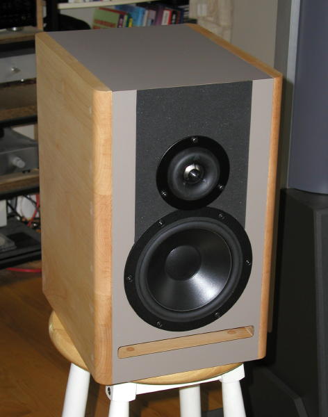

I also like the combination of colors and don't mind if someone copies it. Initially I didn't plan for black surround on the tweeter, but it looked strange (with tweeter that low) and addin neoprene padding improved not only the visual appeal but also acts as decoupling tweeter from the box (the strenght of tightening the screws has an influence here) and helps with reducing some of the reflections. I didn't want to make the whole box in maple as this would look boring (like some of Red Rose Music speakers ;))
