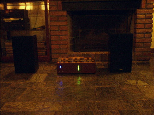

Just tried my (finally) FINISHED "Egad" amp!!! A dual '96JLH with output protection and remote switching.
WOW.
For the record, i used two (partialy fixed) Kenwood speakers and a Sony CDP-M11 CD player, fed directly to the amp. I had good impressions with the brief tests i performed earlier, but the amp sounds amazing! I understand now where all the "tube-sound" fuzz came from; i only had experience with guitar tube amps, but there's a roundness and clarity to the sound that just wasn't there with my old SS AB amp. Bass is tight and fast, the highs are crystal clear and i just can't hear any distortion, hum or other nasitnesses. I'm loving it! :) Listening to "Southamptom dock" through it sent shivers down my spine. Harder stuff is handled excelently; Tool & Joe Satriani sounded amazing.
Now, building notes, for anyone interested... the PSU is 4 Elliot' capacitance multipliers, one for each rail (two per amp), with increased capacitances (10000uf input, 3x1000uf "virtual" cap and 2200uf for output). This, and a shielded E-I transformer led to a VERY low noise output... as in "i have to place my ear half and inch from the driver to hear noise" low. I could have killed that too, but my grounding layout prevents this. And this is with a wooden case without internal shielding.
Transistors are ST 2N3055, and drivers are BD2 34/5. I had my reserves about the 3055's, but they just work wonderfully. I probably switch them to Motorolas some day soon anyway. The DC offset control system is the one Geoff suggested, and works like a charm, and the bias current control is the regular '96 JLH. Everything runs HOT (60-70ºC) with one sink per transistor, but that's the fun of it eh? :)
Well, that's pretty much it. I'll be taking pics these days and sharing it with you guys. THANKS A LOT for all the feedback and help! Really!
I'll be working to the preamp now... :)

Mine runs at 2A, and i can get arround 18w out of it before clipping :) Lovely. About the heat, i'm using 3 sinks that came from a welding machine and one i bought, all of them arround 1ºC/W. It's not as bad as it sounds, but yes, it could be cooler. Perhaps some day i'll replace the whole heatsink (it's on the top panel of the amp which can be dettached).
The output protection is a (slightly modified) project by Rod Elliot (#33 if i'm not mistaken), and it's a relay based one. Works great, and has already salvaged one speaker while testing a power supply! It can also be set to mute the amp during turn-on and turn-off. There's also two led vu-meters on the same board, i forgot those before.
About the remote switching... well, the amp uses a small 9v transformer to power a circuit which senses a "remote on" input, and this stays on all the time. Whenever 1.5v or more are applied there, it turns the amp on via a relay. This is so i can set the amp high in place between the speakers and turn on the complete thing from the preamp with a single button, not having to touch the power amp at all.
And the BD234 and 235. Well, they were the only drivers i could get down here that were reasonable priced and fitted the specs of the original ones. Having said so, they work very well, and could be tried instead of all the other proposed devices.
