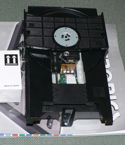

The tray assembly in the CDP-990 is just a standard plastic affair which is similar to the 55ES. It's the actual drive / sled that is vastly different. They are extremely reliable and easy to work on.
This one is from a CDP-991 which has a different mounting arrangement to the CDP-990 but tray etc are the same.

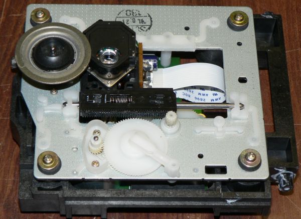

.... but the metal mounting block that includes the sled and drive is a good one. Very robust with rod and nylon guides for the laser device. Compared to the cheap punched metal Sanyo SFP101N in my Cambridge 840C, it looks like a Mercedes even though the Sanyo does work well but will wear out a lot quicker. The laser in my CDP-990 is the original and that was purchased in 1990.

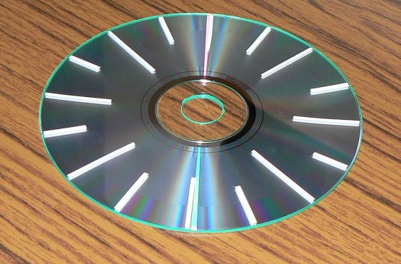

.... for some reason the KSS240A are great trackers and good data retrieval has to be a plus IMO. I have a self made torture disc with 10 tracks. Track 1 has no obstacles, track 2 has 2-2mm lines across the data, each successive track adds another 2-2mm lines blocking the data. Most CD players I've tried only get to track 3 but the KSS240A based players usually drop out about track 7. My old CDP-990 and a CDP-S41 actually fire up track 10.... very spitty and missing bits but has a good try before it hangs.
Check out CD torture (no swipes about the green).

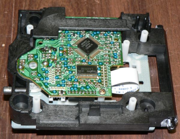

Total height is 45mm from the top of the platter (disc bottom surface) to the bottom of the suspension guides (the 4 white nylon pins in the pic). Can be made less of course with some plastic surgery.

Rabbitz,
you are gorgeous! Is this the whole logic / servo control underneath?
Maybe even one IC alreaty providing SPDIF or DATA/L-R Clock/ Wordclock out?
Do you probably know the clock frequency? 16.9344?

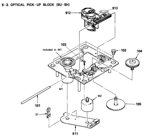

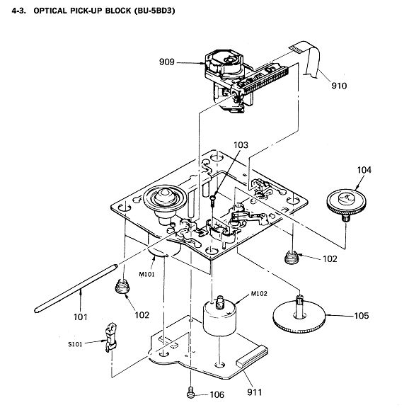

Those pics are for the CDP-991, CDP-295 which does have the servo etc under the drive. The CDP-990 which was an earlier player using the KSS240 had all that on the main PCB.
Most of the KSS240 based Sony players I have use 45.1584 as it lines up with the DAC such as the CXD2552Q. The only CDP-990 I know that used 16.9344 were for the US market that used AD1860N. There are some like the CDP-S41 that also used 16.9344 as they used the TDA1543A. That player could be a good candidate as it was a mini sized player but unfortunately still has the gear for the sled (see pic). Picked up one on ebay a few weeks ago for A$32.
There is a site (Russia?) around that has a list of players with their lasers and DAC which would help with selection to suit a clock frequency.
It may pay to download a CDP-295 service manual just to give you an idea of what's happening in there. I chose that one as I know it's free in this link and does relate to the later Sony players using the KSS240.
http://www.hifiengine.com/manuals/sony/cdp-295.shtml
Another option is always the KSS213 but I have no experience with it other that I had some players from Sony, Yamaha, Rotel that used it in recent times.
