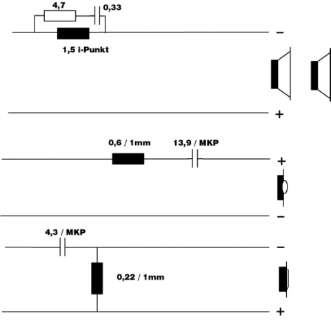

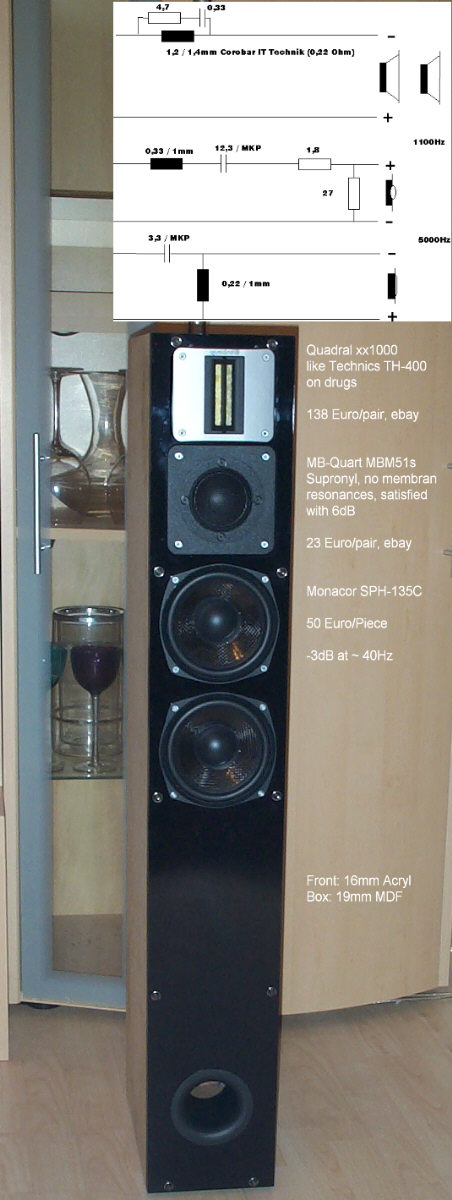

I don´t know if this is still meant as introduction or a loudspeaker project!?
This is my actual design for my small kiving room.
Not perfectly finished, the crossover still needs work.
Wombat

Also i didn´t gave up! It sounds damn good this way!!
The Supronyl dome is the best dome i ever used - perfect roll-off,
no resonances. With these 6db filters it behaves exactly like a 12db
filter up to the ribbon and down to the basses.
The monacor chassis itself isn´t usable ober 1000Hz and falls down in
preasure from there on, so the 1,5 mH fits also!! No prob here,
cause it is only meant to work up around there.
Monacor themselves payed an ape to paint the frequency plot of
this SPH 135C. It shows linear preasure up to 4000Hz - lol!
All is fine. I just started to go deeper with OP Amp testing therefore.
The speakers have a good resolution and now the first time i can hear
every OP behave totally different. I will have to start OP swapping in my
DAC again from the beginning.
