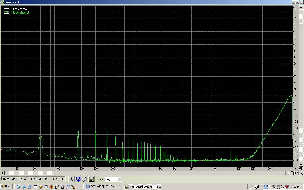

With the USB latency problem fixed I can now run RMAA at 192 kHz and 24 bit. With this higher sampling rate RMAA can show noise and THD at higher frequencies. It starts to rise, quickly, at 30 kHz.
Jim

There are quite a few spikes there, starting with the one at 60Hz. Was that image taken with the loop back cable in? I get such distortion only if my volume pots are set to maximum.

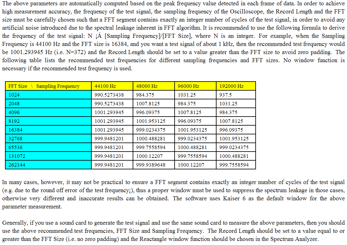

Jim, do a search in the MI help window (see Menu->Help) for SNR and you'll find a table with values, what to set the sine generator to (frequency) and what the fft windows should be etc. A few other things;
* from settings choose ADC device to be your ASIO driver
* mute everything in Windows in the "Adjust Audio Properties" (right click on the speaker icon bottom right)
* if you didn't calibrate with a rms voltmeter, then use dBV instead of dBr
* use 48kHz, 24bit for THD tests
* right click on the fft window and make some sane choices there, for instance I choose linear average of 10 samples
I agree with you, for higher than 22kHz I think something else will do a lot better than these sound cards.
Edit: added table.
