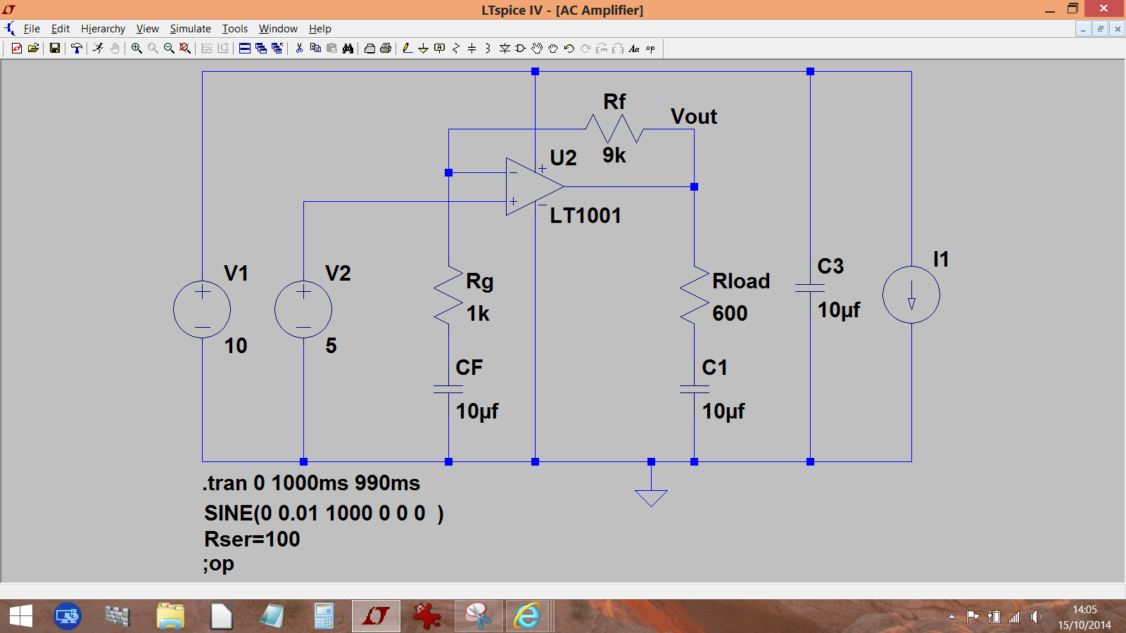

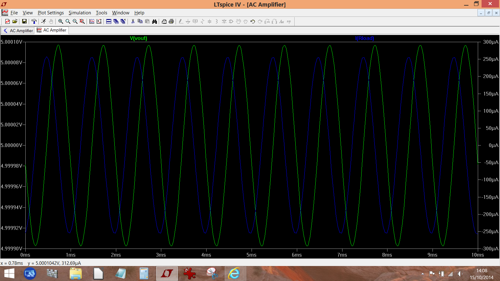

Example 1. A simple AC coupled single rail amp. The load is returned to the point marked ground. That point becomes an absolute reference. It is where all other values are measured from. To make this reflect real life there is a small (10ma) sine wave current taken from the supply. The supply has also series impedance such that this 10ma current will modulate the rail. Just as happens in a real design. The impedance might seem unrealistically high but consider an expiring 9 volt battery and its internal resistance. The amplifier is under a no signal condition with the input biased to the midpoint voltage (5 volts).
So that is the basic circuit. If we look at the output voltage and output current we can see they are miniscule. Theoretically it should be zero... are we seeing the supply rejection of the opamp come into play ?

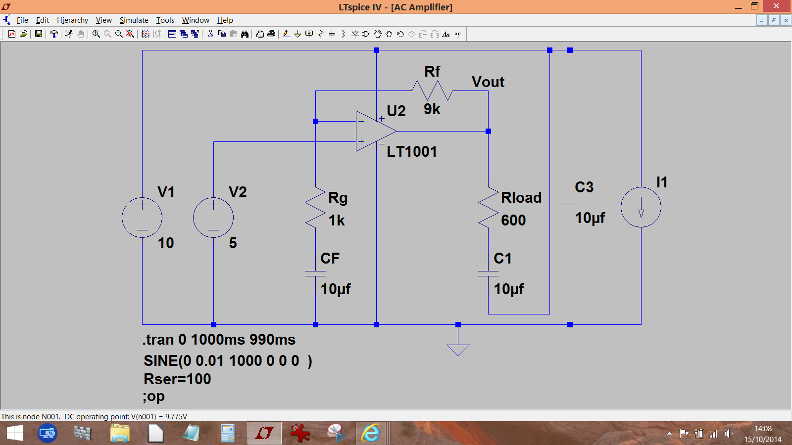

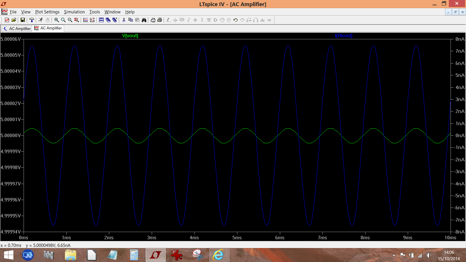

Now we change the amplifier such that the load is returned to the positive rail (which you imply above is at AC ground)
Again we look at the amplifier output. Look now at the scale and the amplitude of the signals. There is considerable rail disturbance flowing in the load. That is caused by the rails not being at the same AC impedance. It is a real world example of what happens.

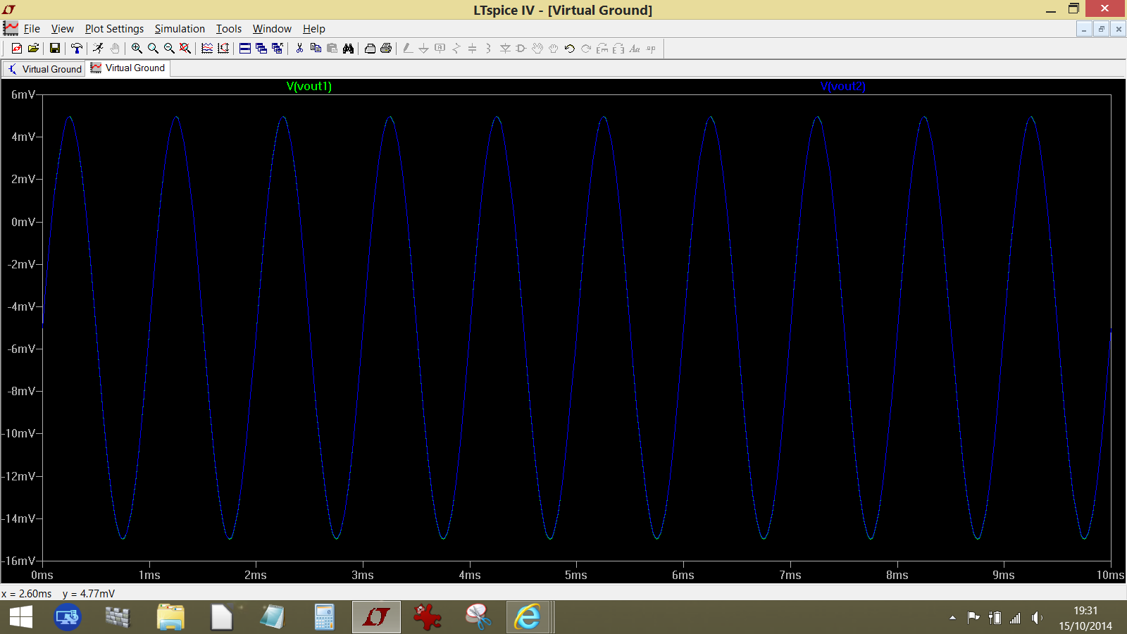

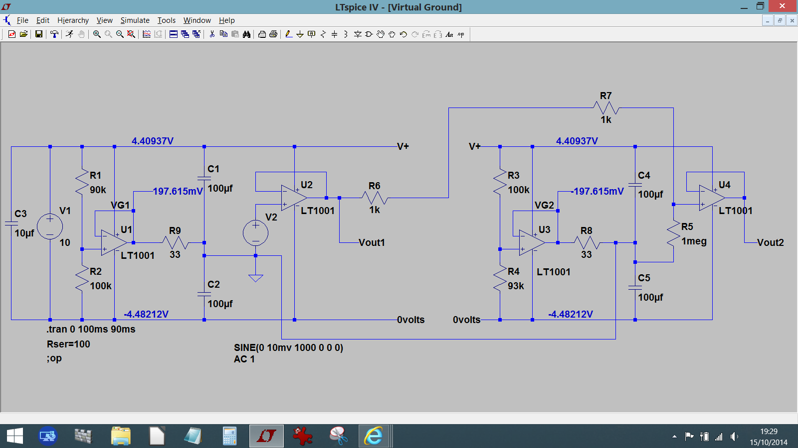

It all seems to work in simulation. Notice the deliberate imbalance of both virtual grounds. The output of the final stage still accurately reflects the input of the first. The current in the 33 ohm resistors are equal and opposite (-6ma and +6ma). There is no DC offset at either output. I deliberately added a -5mv offset to the input signal which is accurately passed through the system. I added a resistor to the first VG opamp because many opamps don't like to see capacitive loading directly on the pin although that really applies to small values. Anything large would kill any instability. Its there, it works.

You should be able to get the differential down below 10mv (I would have thought so anyway). A big variable could be the opamps for the virtual ground. If these are bjt devices rather than FET they will have relatively large and slightly unpredictable input bias currents.
Oh by the way, these are TI parts, LME49721. They really are very good rail-rail (5V max) OP amps, and their offset V is only 0.3Mv. So I haven't really figured out why the difference between my V-Gnds was that much. But at elast i can say it likely is a true worst case.

Thanks. OK Mooly.. I think I'm confident enough to put this to rest now. Regarding LSpice, I do have the capability of generating the files from my DesignSpark PCB software, so maybe I'll try it with my own circuits (I need the experience doing so anyway). I guess for things like this, I probably wouldn't trust the simulation 100% anyway. But it doesn't hurt, and sometimes it does point out surprises.
